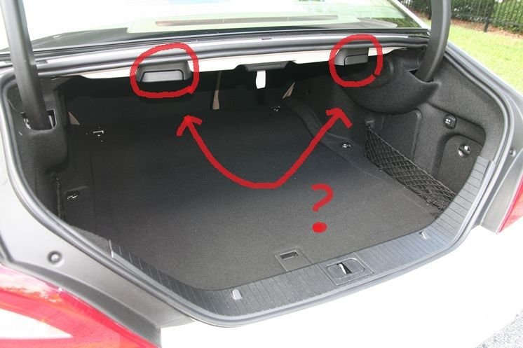

how use that things? what's the purpose of that?
there's no compartment on 2015 cls.

are those things covering the attachments for the slide out adjustable grocery holder?
I have it and thats where it attaches to the body.

i dont have a cls but that is the releases to fold down the rear seat on my clk

It does the same thing on the CLS.

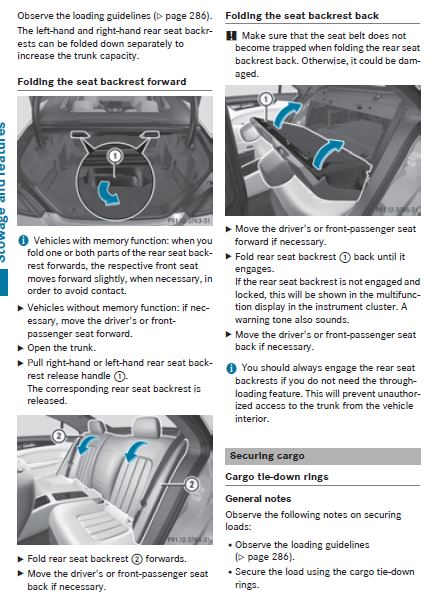

Manual...
