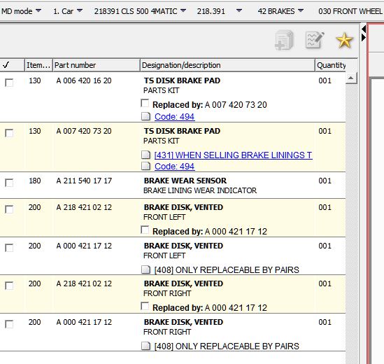

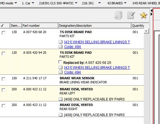

Reference bulletins LI42.10-P-063149 & LI42.10-P-063150 thickness fault on brake discs installed @ production – front/rear disc/pad replacement covered under factory warranty. Separate from 1-year/12,000 brake warranty and 50% wear factor. Speak with service manager, if refused contact MBUSA https://mercedes-benz.custhelp.com/
Attached Thumbnails New 1 year/22K miles CLS550 need new brakes-front.jpg   New 1 year/22K miles CLS550 need new brakes-rear.jpg
