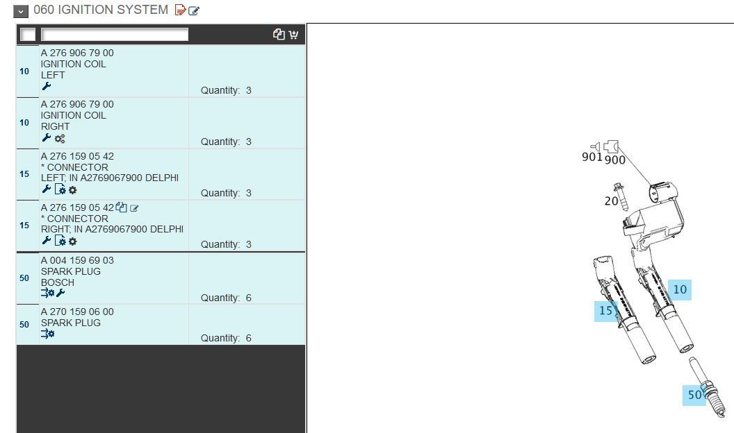

OEM plugs 0041596903 optional w/ 2701590600, see attachments.
