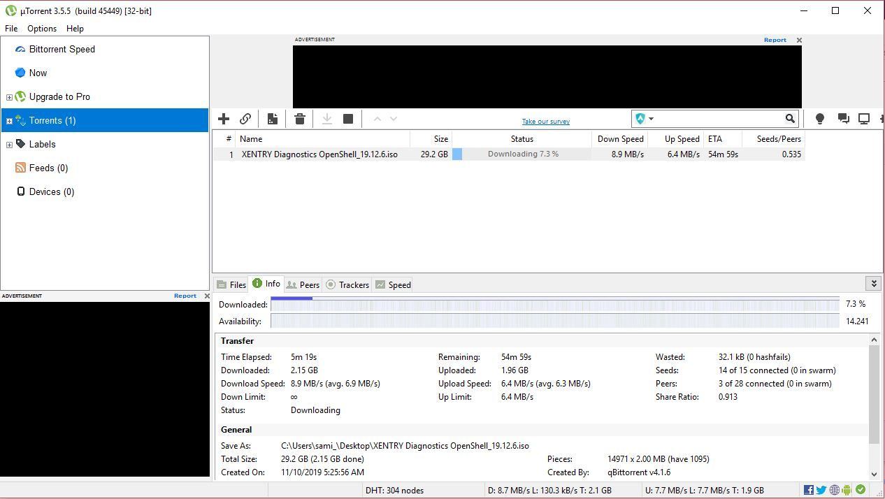

I just got the phone with MBHouse. they send me the files/software to download via UTorrent (30 GB and very slow download). on the 21st at 10 AM they will contact me and install the software on my multiplexer and on the 23rd we will perform the services I selected.
on a side note, I had to create all sorts of exceptions to allow the download and install on my PC. you will need to turn off the firewall and antivirus to start the download. ALSO A BIG ALSO, you do NOT need a windows 7 PC anymore. you will be able to to install on your windows 10 PC as they ewxplined that MBenz dropping support for windows 7

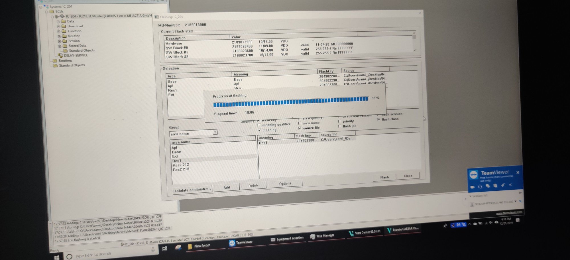

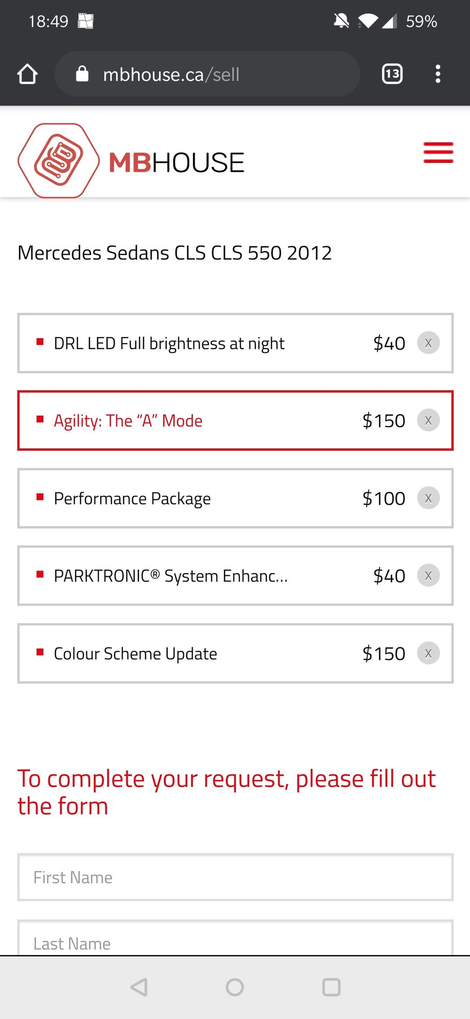

For a start this is what I'm getting now. Not sure if I will add more but this is it for now 🤦🏽‍♂️

This is my list:
I want their dashcam too if its not too hard to install
Not sure if the color scheme and AMG menu are the same thing but i listed both there.

Reporting live
MBhouse have been great all day process and we still didn't finish BUT they coding as we speak. I will give you guys the run down later. The multiplexer itself is not the issue it will be the least of your problems. I recommend a laptop with 200GB free and has to be the main drive. I have about 160 gb worth of software today.
Again I can't speak enough of MBhouse . Top notch
