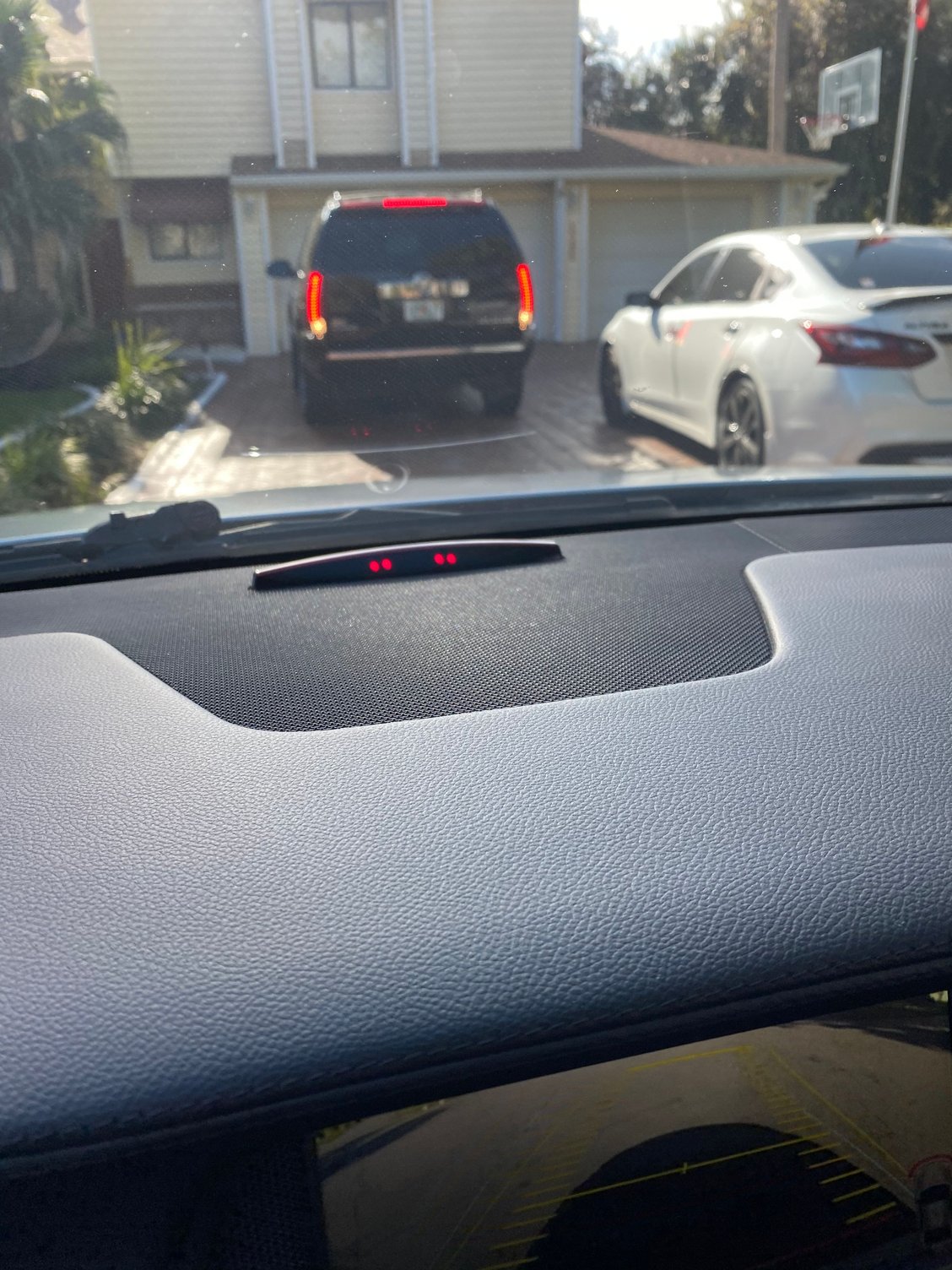

The sensors go off sometimes ..... when I started the car this morning and put in reverse the sensor beeps and lights go red. So I put in park and turn car off then back on and everything is fine ? This has happened a handful of times. Has anyone else had this experience ?

Check sensors in bumpers as addressed in attached bulletin.

thanks for the info, I will be checking down that list I do know my brakes have been squealing since I switched to the organic ones And ceramic pads so I’m wondering if that has anything to do with it either way after work I will be going over the information

that’s the first thing i did the first time that happened and I always wipe them down and they don’t have any scratches or anything On them either. I’m going to look at them again in the morning I gotta leak coming from my windshield fluid as well I gotta fix so I was going to open it up and look at it tomorrow and I’ll double check all the sensors. Weird thing is it usually happens in the morning when it’s colder than usual. I’m not sure if that has anything to do with it just seems like a common thing when it does happen

I can 99.9 percent say it's gonna be your battery, I had the same issue with my car, replaced the battery and it's fine.

i was thinking that as well I haven’t changed it since I’ve bought it and being in Florida it’s probably about time. Was also thinking the aux battery as well

Same issue here and my mechanic said it is the battery.

I had the exact same symptoms a couple of years back. Then I bought a battery tender and when the car is not being used for a few days, I hook up the tender. Problem has gone away last winter and no issues this winter. So I agree with everyone who says the battery is the issue.
