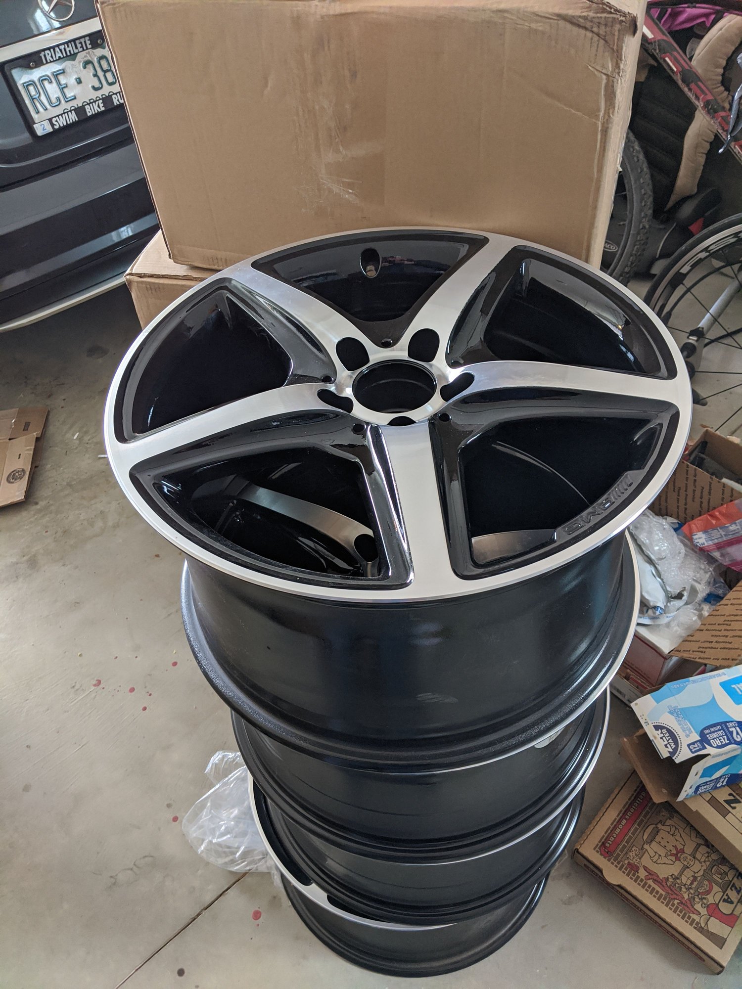

Since I bought the car from new I went back through the paperwork and found the original spec/feature list.
The wheels I have are part numbers and I went ahead and looked up the specs.
OW85232
2012-2014 Mercedes-Benz CLS Class (218 Type) (Note: CLS550)
Size: 18" x 8.5", 5 Lug, 112mm Bolt Pattern
Finish: Silver
OW85233
2012-2014 Mercedes CLS Class (218 Type) (Note: CLS550)
Size: 18" x 9.5", 5 Lug, 112mm Bolt Pattern
Finish: Silver
I did find a couple of the back wheels on ebay, but not a front wheel.
I did however find a set of OW85230B/OW85231B which are the same size and were the alternate wheel set the dealer tried to sell me, so I've ordered the set.

No I ended up ordering from a company in Canada, $1750 for the set inc. shipping, 2 back 18x9.5 + 2x front 18x8.5 come with a 30 day warranty.
Yeah thats why I didn't get those wheels when I bought the car, the dealer wanted $4,000. This way I can see the 3-good wheels on ebay or here, and recoup enough of the cost to cover the cost of new tires.

I had 20 inch Verde on mine and with the low profile tires, my rims are screwed as well from pot holes. I’m in Winnipeg Canada and am looking for 19’ to smooth the ride and hopefully save the semi-annual rim repairs. Do you have pics of the new rims? Also where did you end up getting them from? I have looked and found some nice rims, but most times when I look for fitment they don’t work. My local MB dealer wants 5000 just for rims, no thanks.

I ended up buying this set for $1750 US from originalwheels.com who are in Ottawa. They were excellent given whats going on at the moment. They are used wheels, original AMG. I'm going to have them installed tomorrow.
Set of 4-wheels, 2-back, 2 front, $1750 inc. UPS ground shipping.

Beautiful wheels, make sure your tire circumference is almost the same, front to back. Within 3% if you have 4Matic. Get a taller sidewall than the OE 19" you had. That will help you with the pothole problems you've seen. Marv
