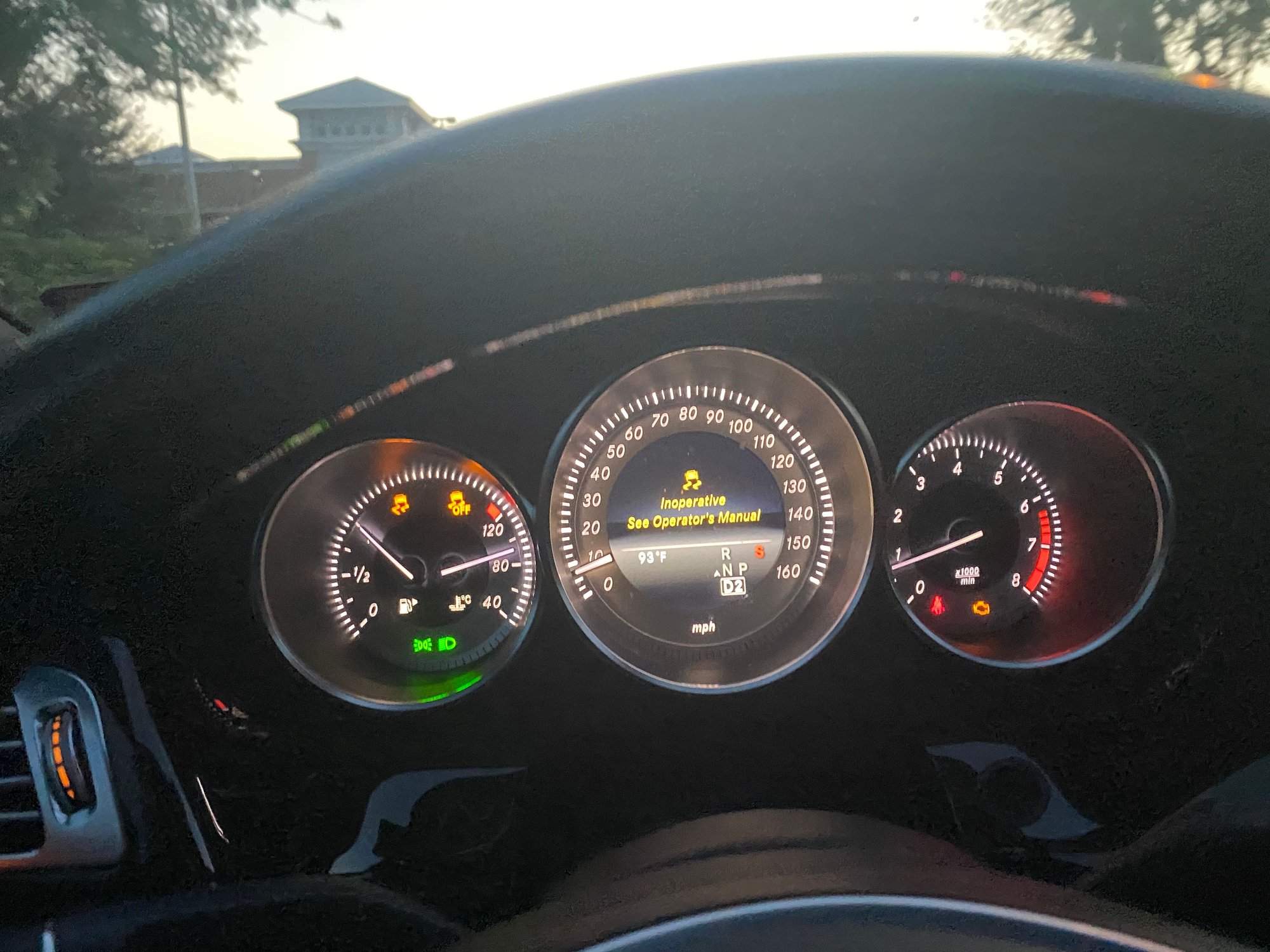

Anyone ever have this light come on and couldn’t accelerate ????

"I had simiar experience and it was a faulty gas pedal. Replaced and no more inoperative traction control.
Though i think you still need to find out what code has been store to really make it sure.
If this happens in often it could throw a permanent code. Or you can check right awa while is inoperative."

Awesome I will do that it’s happened about 3 or 4 times in the past two months I got my computer coming tomorrow so I’ll keep with me so when it comes up I can plug it in thanks for the tip !
