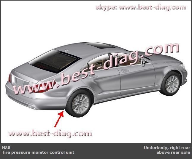

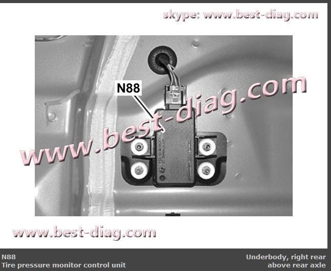

where ist tpms module on cls w218?
hello
where ist tpms module on cls w218? tire pressure module? i cant find

For future reference, you will need to identify module # (i.e.: TPM = N88): http://benz.ehost.tj/218/webetm/webe...rt_finder.html
