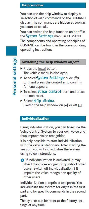

File Type: pdf

Thanks I’ll give it a try tomorrow

somone solution or not my voice recognittion was totally not working i fixed that by resetting to factory default but still is not repsonding on calling someone.
