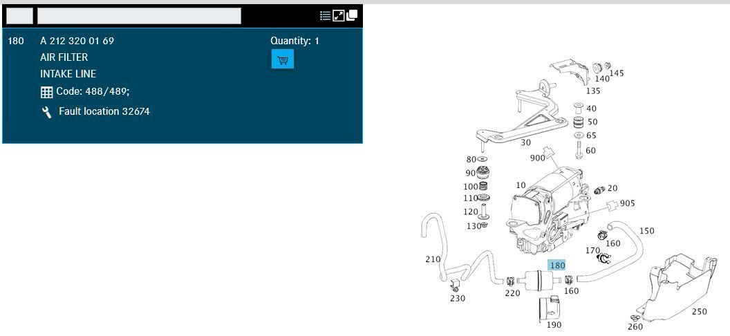

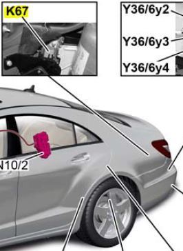

Certainly, involves spraying locations specified with soapy water. If you find no leaks, garage claims all was checked properly including no fault codes (i.e.: compressor), and they did not check filter & relay proactively try this.

Thanks alot this was super helpful. I've organized the information for my garage.
The problem with it is it happens sometimes and not other times. Like sometimes overnight the front left suspension completely falls and the car is on the tyre, other nights it wont happen for days at a time.
