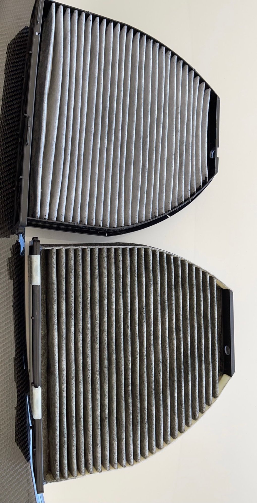

Replacing the inside cabin filter is not difficult. In my '13 CLS550 it's in the underside of the dash inside the passenger footwell. Search YouTube for videos showing the replacement.

Cabin air filter isn’t difficult to remove and install. Just make sure you don’t drop the clips inside the footwell area because I lost one of mine. I have one clip now and it holds up just fine with one, the sliding locking mechanism holds it in place already. My A/C was giving that awful smell; haven’t gotten that smell since replacing it. I also sprayed a bunch of Lysol into the area where you insert the cabin air filter, then left the A/C on full blast with all windows down for like 20-30 minutes.
