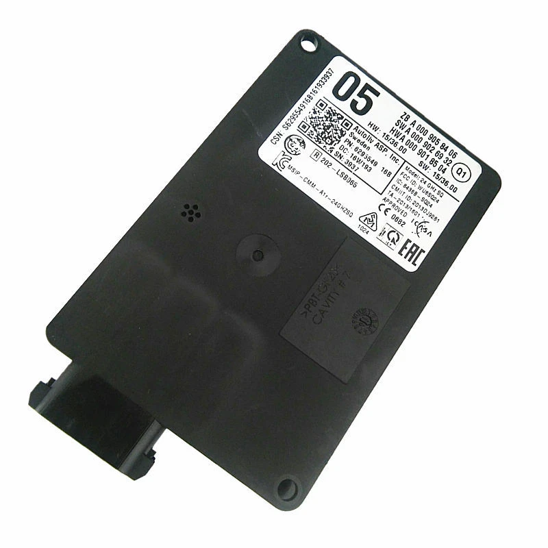

The other day I'm reading an article on the 2015 CLS400 and see that "Lane keep, blind spot, forward collision, and adaptive cruise" are all in the same package.
I'm not exactly sure I believe that, but I DO have Lane keep, blind spot, and forward collision.
I do have radar sensors in my bumper, but it is listed as 05, and maybe 10 is needed, I think 03 is only blind spot.
So would it just be a matter of swapping the radar sensor (if it's needed) and adding the star, and maybe enable in coding? I still have all the adaptive cruise menu's in my car and they identify lanes and stuff.

It would be this radar sensor:
vs

Also apparently I have:
22P Lane Tracking Package
234 Blind Spot Assist
258 Collision Warning System With Active Brake Application FCW-Stop
476 Autom. Lane Recognition
vs
You would need one on the right and left of the rear diffuser. My right one had so much dirt on it that the car was thinking a car was about to hit me. My seat belt would tighten, and this would happen for my entire trip to a store. I eventually turned the system off and cleaned it lol.
