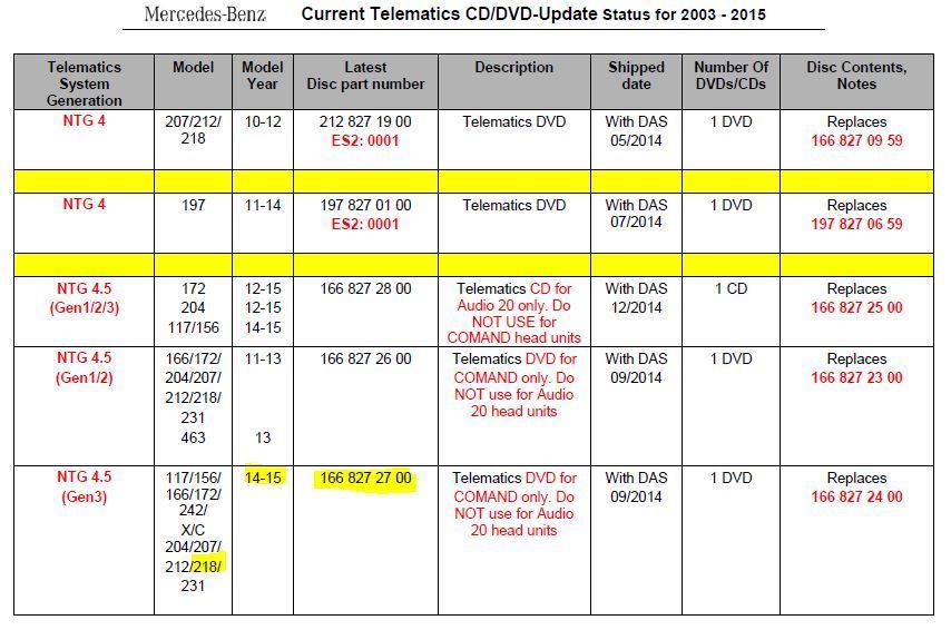

I am trying to figure out what the correct part number is for the telematics DVD so I can order it to upgrade with Xentry. Would someone please confirm that the correct number is W220589042200?

220589042200 is navigation processor update not applicable to 218, Telematics DVD is 1668272700.

Does Mercedes keep the same part number when they release updates, or do updated DVDs have a different part number?

Revisit chart 1668272700 replaces 1668272400.
