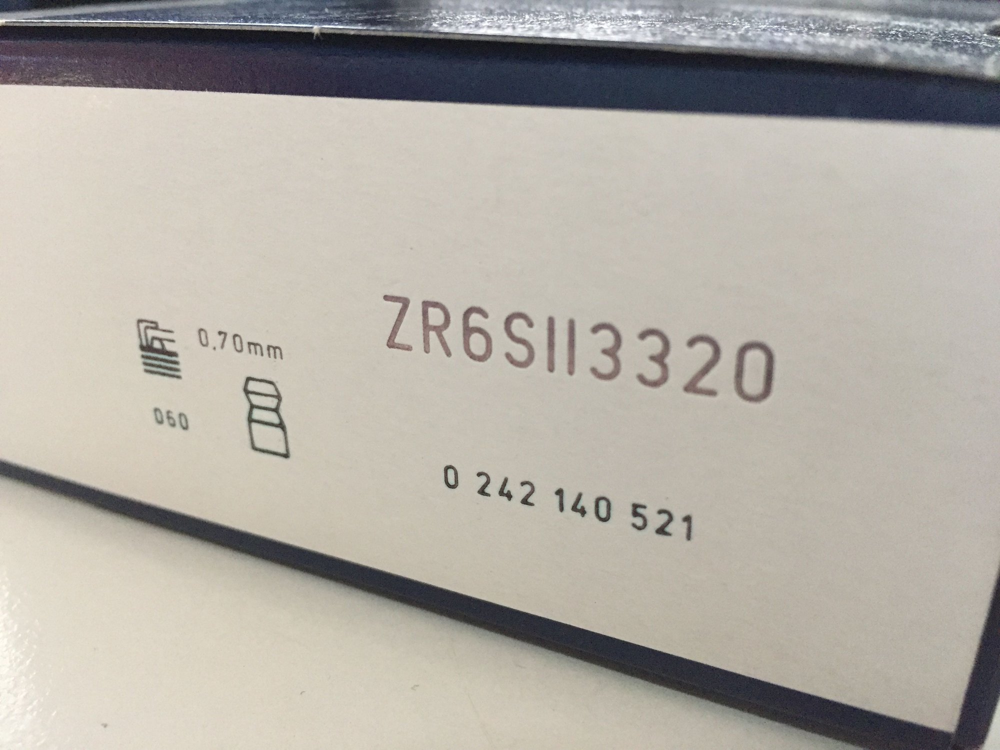

I use the ones you mention: Bosch ZR6SII3320 Pics below
BOTH: ZR6SII3320 & ZR6SII3320R are compatible. You can use either, I just wouldn't mix them.
Spark plugs that have an "R" at the end of the part number are usually a Resistor type spark plug. From what i understand, they're meant to create less
radio frequency interference (RFI) which can cause misfiring and "noise" heard through the radio.
