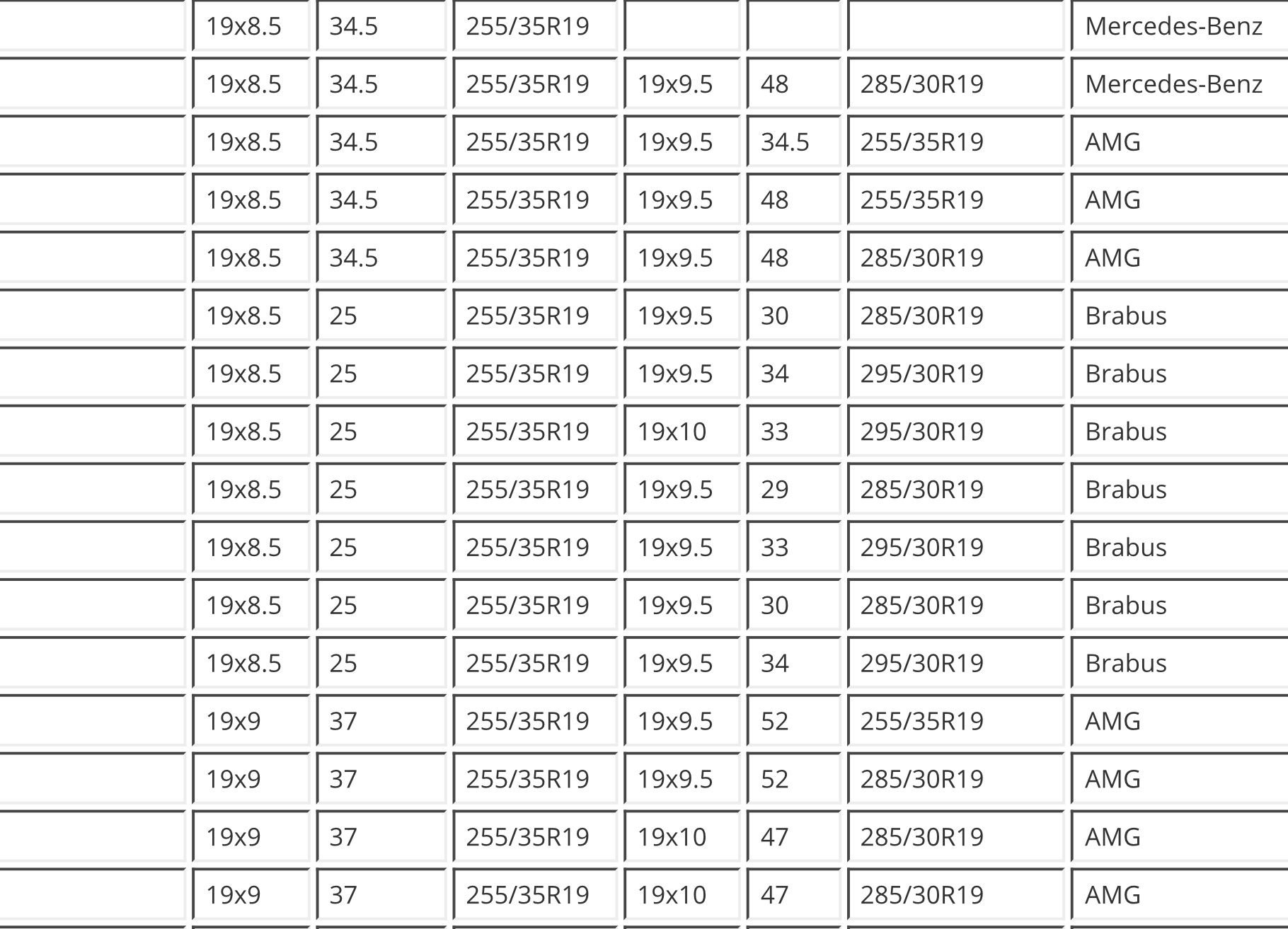

Mercedes-benz wheel fitting chart
Found overview of alternative rim tire dimensions front vs rear on my W218 Possible to deviate from standard dimension front 255/35-19 rear 285/30-19 … 19x8.5 34.5 255/35R19 and 19x9.5 48 255/35R19 may be a good alternative for studless winter tires her. At the rear you can deviate from the standard up / down but at the front the only option is 255 / 35R19 unless you compensate with spacer.
