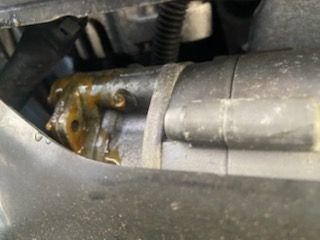

What is this
After taking the plastics off of a 2012 cls 550 I stumbled upon this. Originally I thought it was oil leaking but it's actually hard almost like somebody use some type of insta seal? I just purchased car and had a PPI done and all they came up with was front crank seal was leaking oil. They're a reputable shop but I feel as if they didn't even inspect it properly or I should have been alerted to this. Upon researching everyone's saying how front crank seal normally doesn't have any issues or is that incorrect? Any help on what I should do with the pictures would be appreciated.

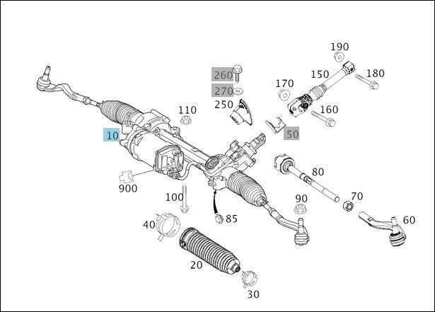

Looks like steering gear electric steering motor (A91m1). MB EPC does not show this part separately only steering gear if replacement needed try searching part # found on part installed.

That is normal. It's wax sealant applied to keep water out of the electric steering components. It's added at the factory however older cars had a recall to apply it at the dealership.
