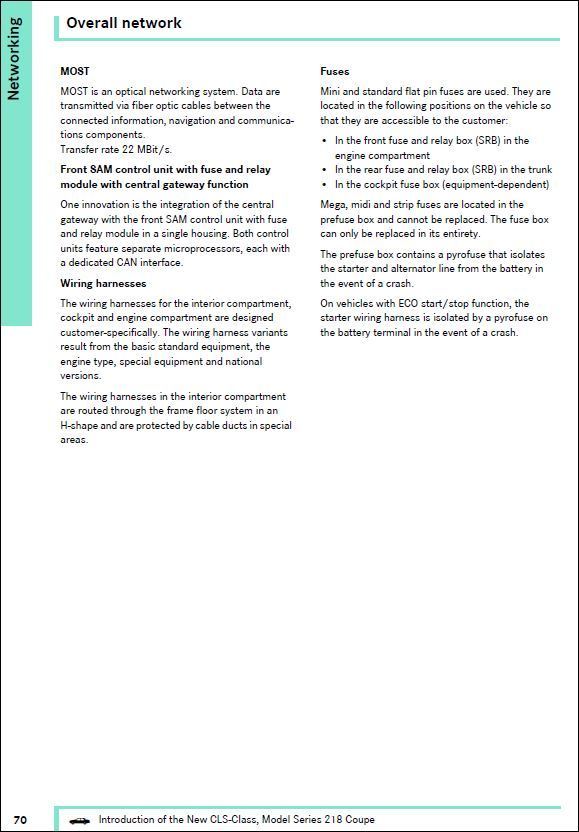

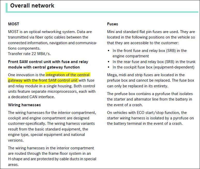

Good evening, folks. I have a MY 2014 (pre-facelift) C218 CLS 63 AMG with what appears to be a Central Gateway problem, but I can't find the unit, and the parts man at my local dealer can't seem to find it either. I've seen somewhere on here that on some W212 E-Class (and the C218 is basically a 212 under the skin) the Central Gateway is integrated into the Front SAM. Does anyone know for sure whether that applies to the MY 2014 E-Class?

Thank you for that.
It's a really good innovation for the MB parts operation; if your central gateway goes down, you have to buy an entire front SAM...
