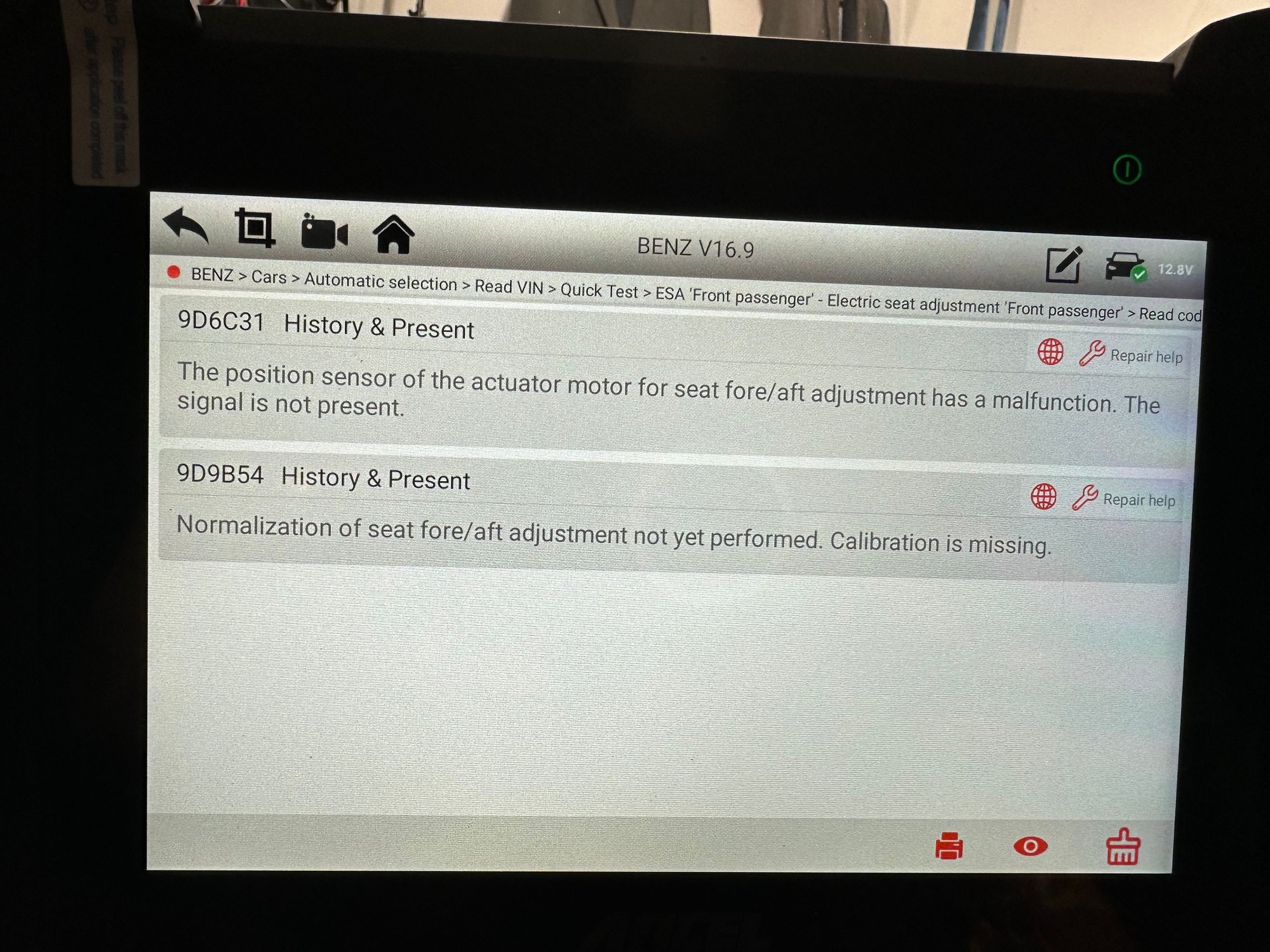

My 2016 cls550 on passenger side just noted that seat won't go front and back, hear click when I push button but it won't move back and forth. if I touch memory seats it does move back and forth but not by switch. does anyone has any advise on where to start? than you

This is the error coming out. please help!

Delete codes if they return seat may need to be normalized, find an independent using Xentry (MB diagnostics).

I did, code comes back. I guess I have to find someone to sync it. thank you for your help!
