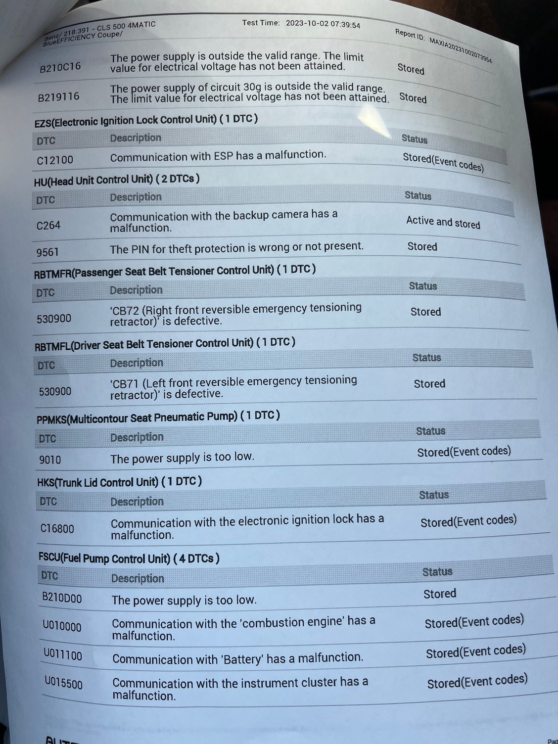

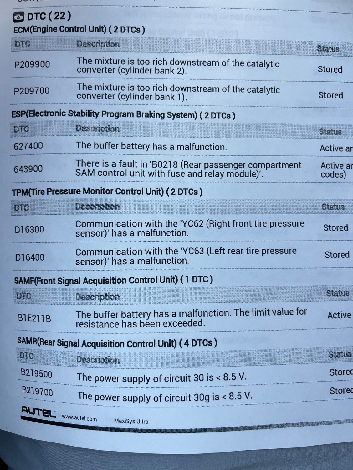

Potential car I was looking to buy. It was just traded at a non MB dealership. I was able to check it out just after it was traded. They have not been through the vehicle yet to address anything. I will post pics of what came up.
Not sure if auxiliary battery replacement may take care of some of these. The auxiliary battery malfunction message was on display.
Any help would be appreciated.

This scan is useless
you'll get these results also if your battery was low, then you started, your voltage shortly drops to 9v during this
many modules tilt
also by disconnecting the battery
start by clearing all faults
then start and drive the car
then scan again

I agree - most of these could be caused by the low voltage.
