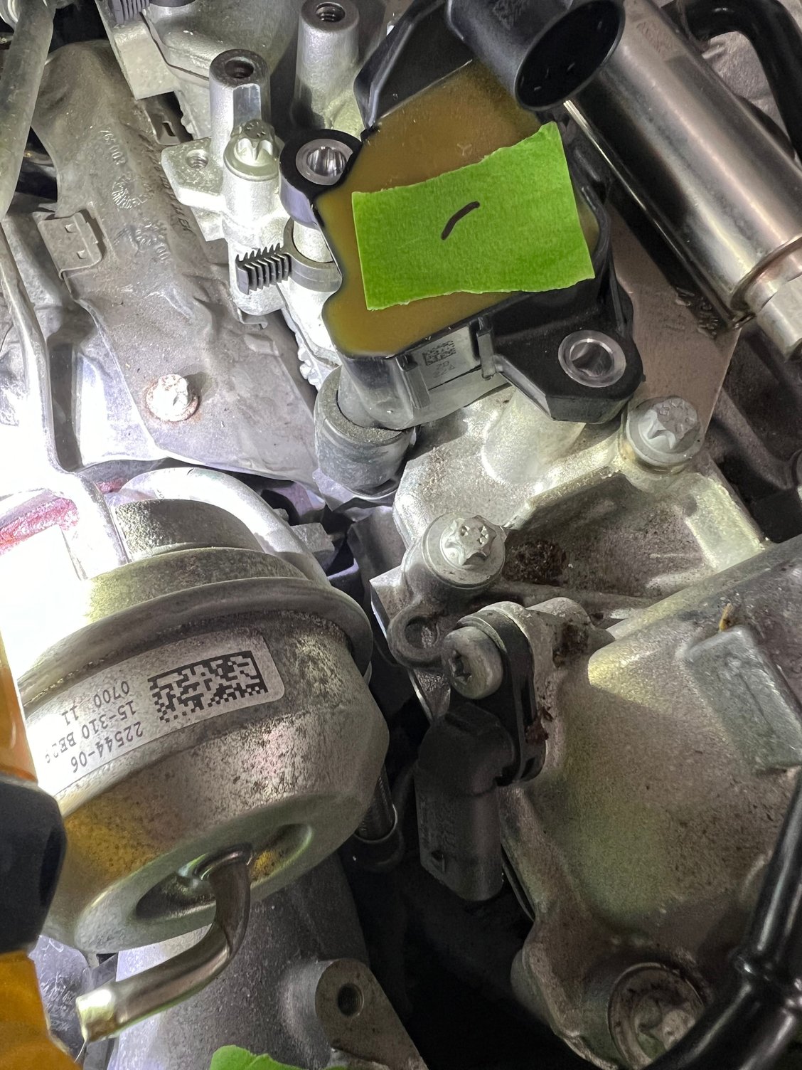

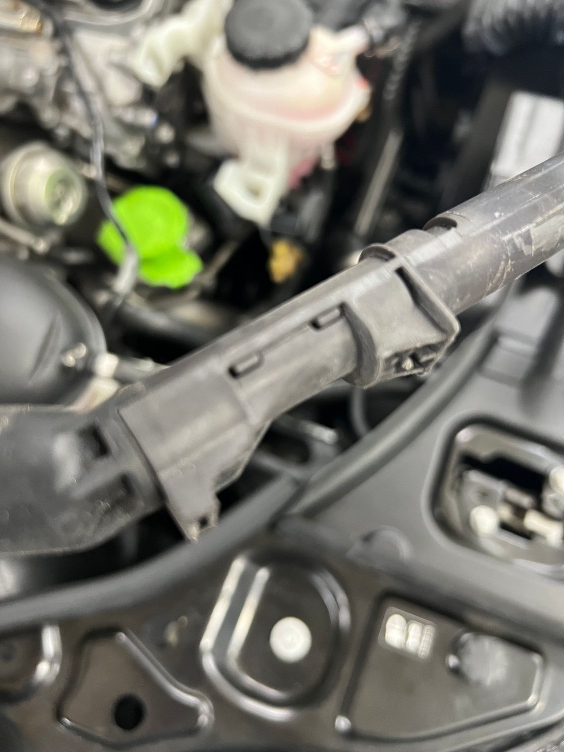

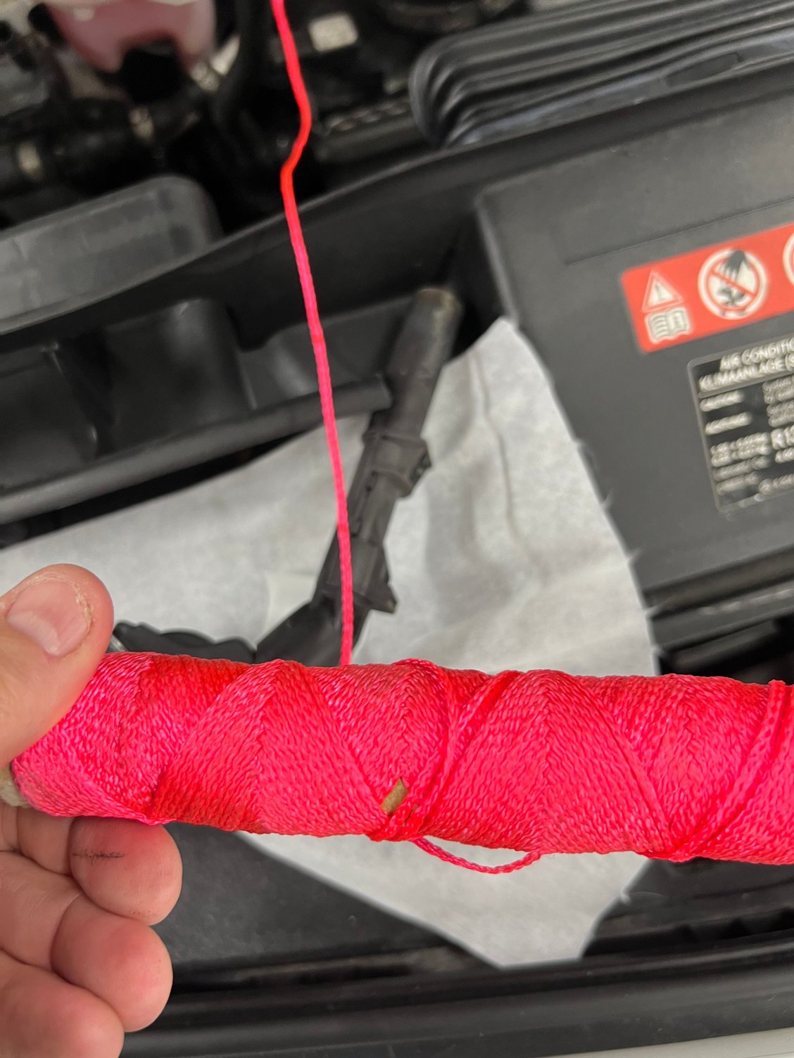

Tip. The spark plug coils on these are like welded on. Do not just yank on them. Note that the center has a hard plastic boot of some sort. Make a loop with a string and work it down to this section. Roll the string up and it will give you leverage to pull it out. Mine still were crazy and I’ve read that warming up engine before doing this is a good idea.
