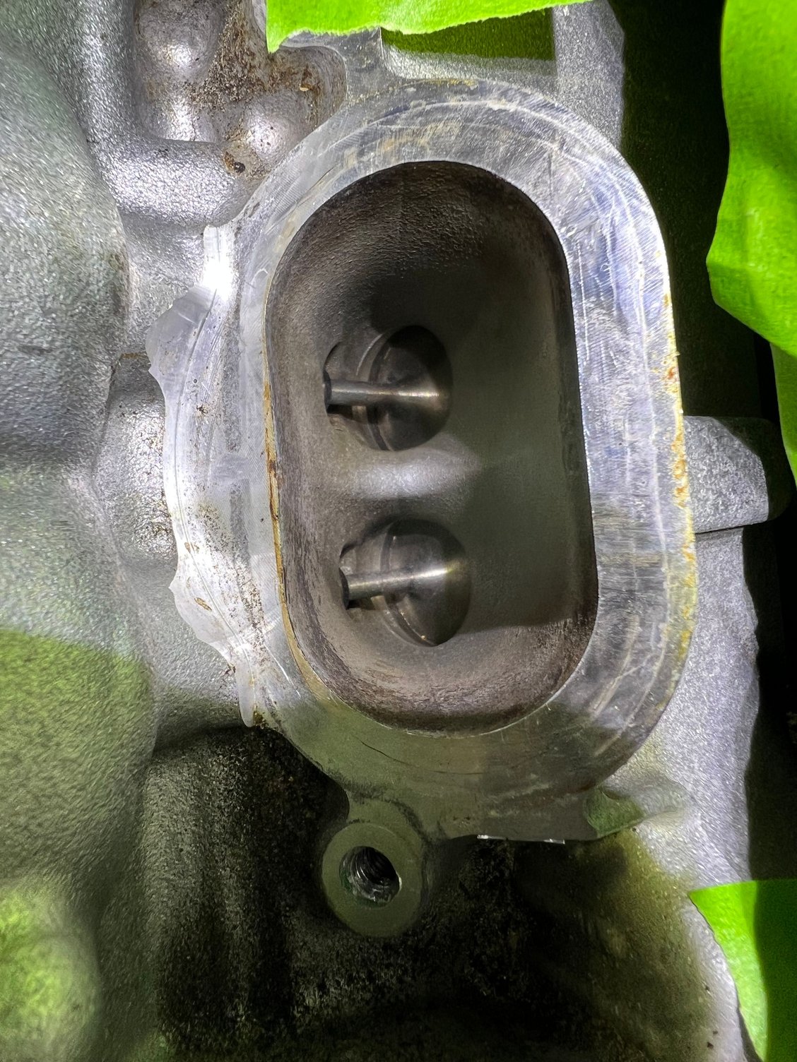

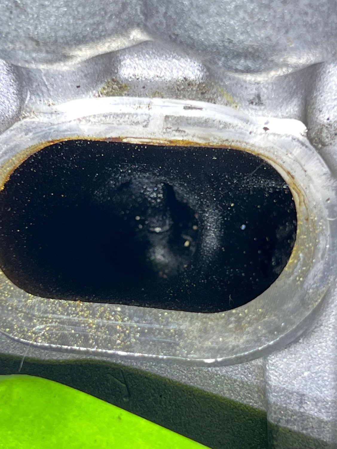

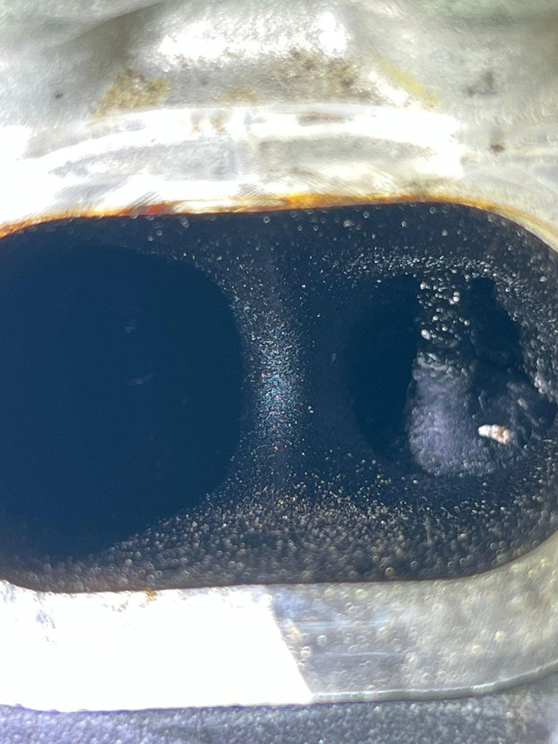

Since I already took off the manifold off to get to a check valve with line to oil air separator I looked at the valves. Direct injection so they look like ****. I researched walnut blasting and came across instructions to make a kit for $100. Results are amazing.

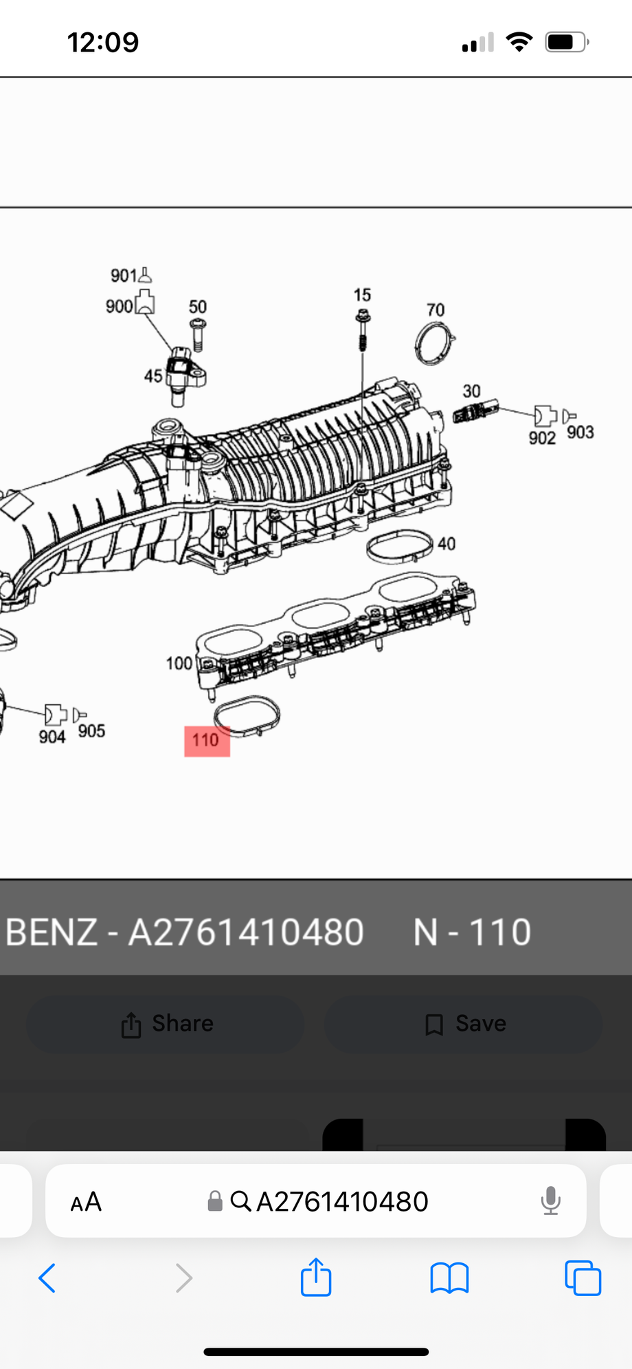

- note the gaskets on intake are different part numbers from spacers although they look the same. Be careful.

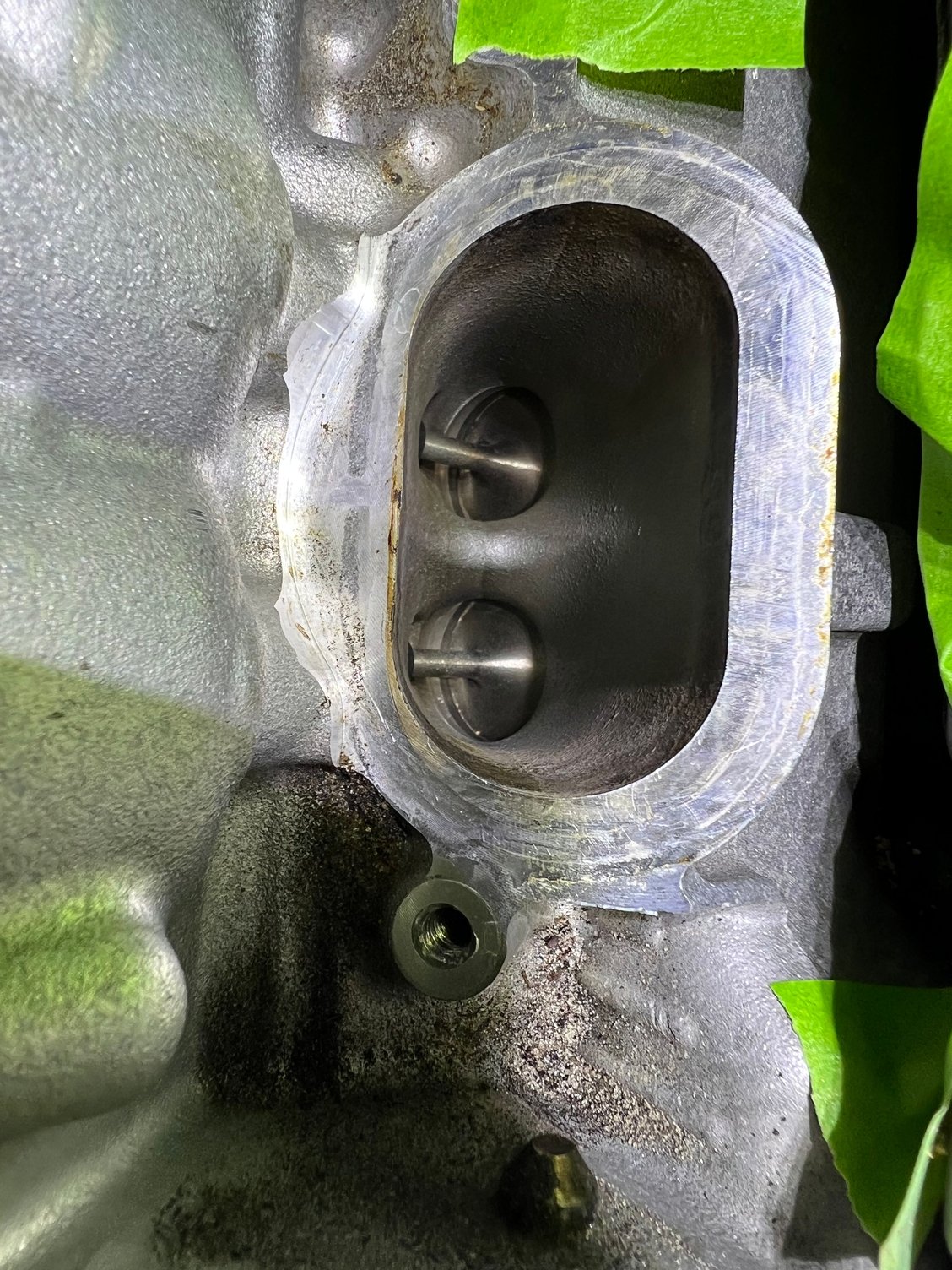

​​​​​​- insert adapter attached to vacuum. Insert walnut gun and blast 30 seconds. Use picks to get chunks off valves. Blast again. Use brake cleaner and rags. Watch a lot of videos. This part is oddly satisfying.

this is where I am so far
