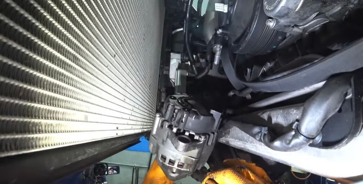

I have a 2012 CLS 63 that needs an alternator replacement. I have performed this same alternator replacement on a 2013 ML 63 without much effort since it came out of the bottom.
Im hoping I don’t have to remove more than the fan and not the rack. Does anyone have information on the procedure or instructions? I’ll post pics once I’m done with the job if anyone can be of assistance.

I replaced the alternator in my W209 yesterday and was able to do the job entirely from the engine bay. No need to jack the car, remove panels or crawl underneath. This small 3/8 pivot head socket wrench was the perfect tool to reach the blind etorx bolts. Powerbuilt Swivel Head Ratchet,...
