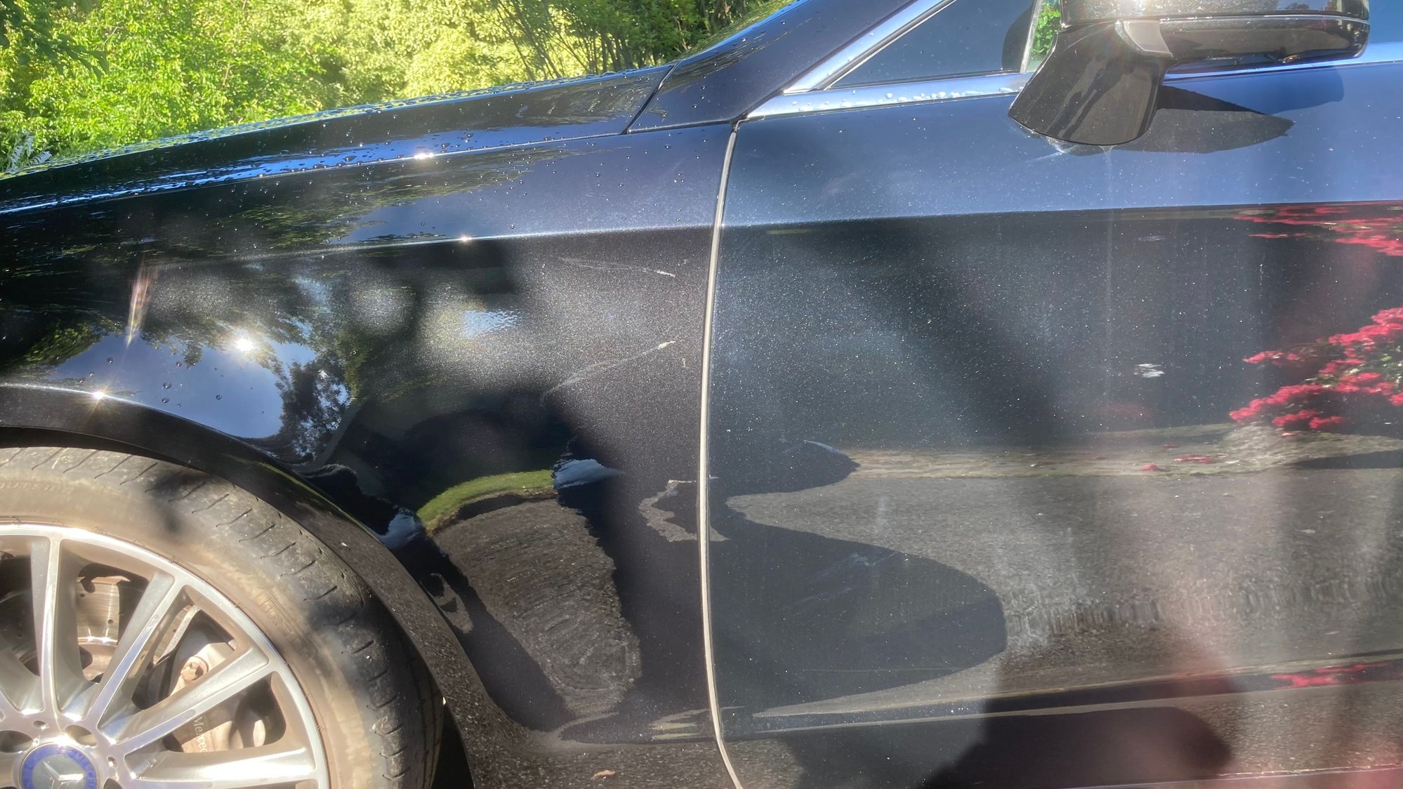

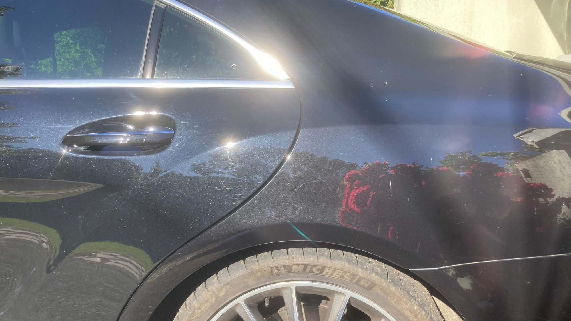

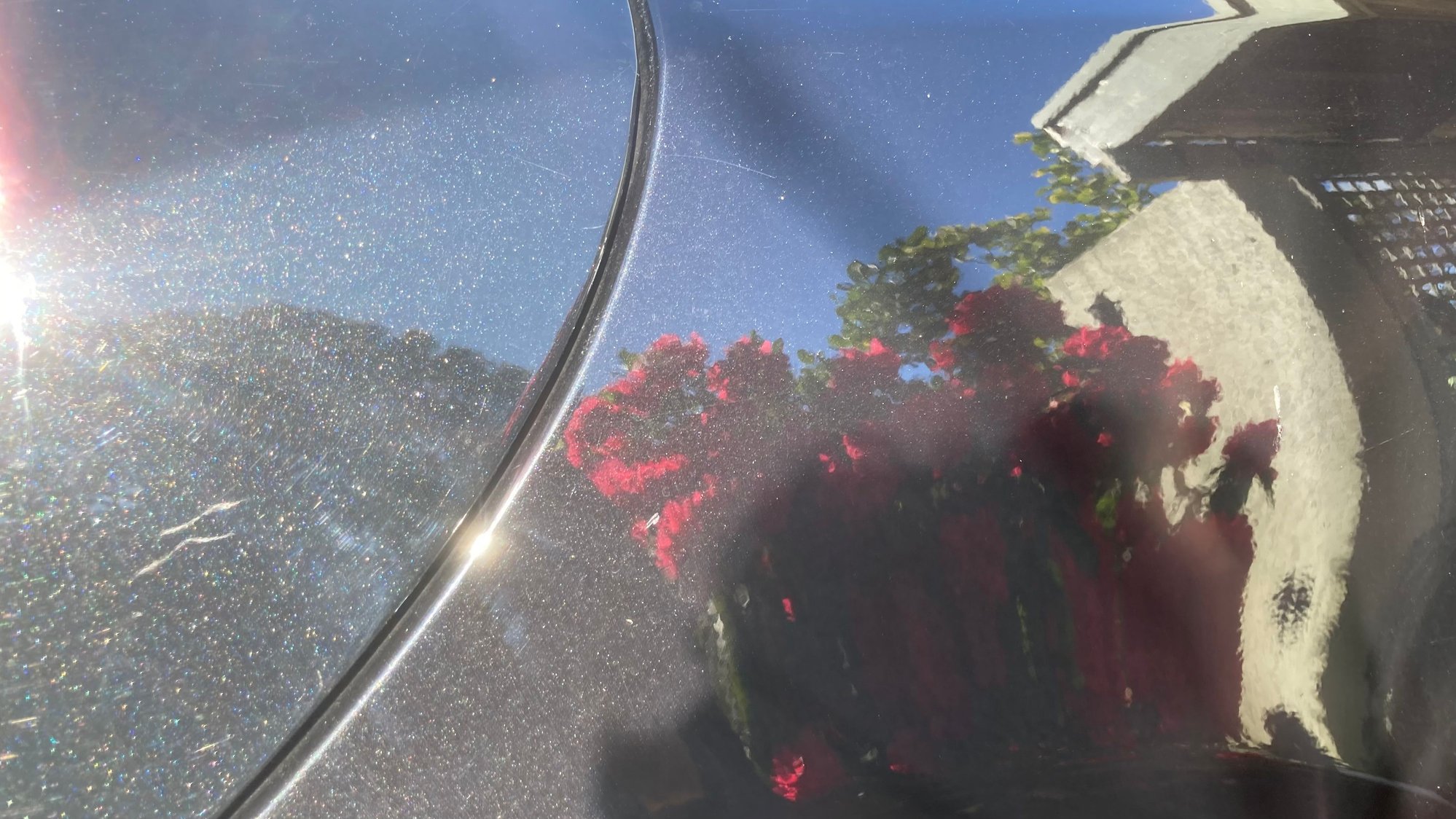

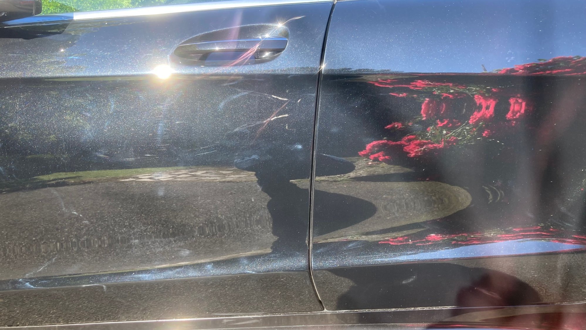

Hi,
Bought this CPO 2015 CLS400 with 67k kms, no accident history that I was made aware of. In the sunlight, I noticed that two doors were a different colour to the body. Is this is acceptable variance from factory or has it been painted?it’s supposed to be a 197 obsidian metallic.
Photos attached. Thanks.

Painted or replaced (this one most likely) is my guess.
Get a paint gauge (Microns Thickness Coating Gauge) and measure the paint thickness.....if it was painted, a variation in thickness will be obvious (usually thicker when painted)
