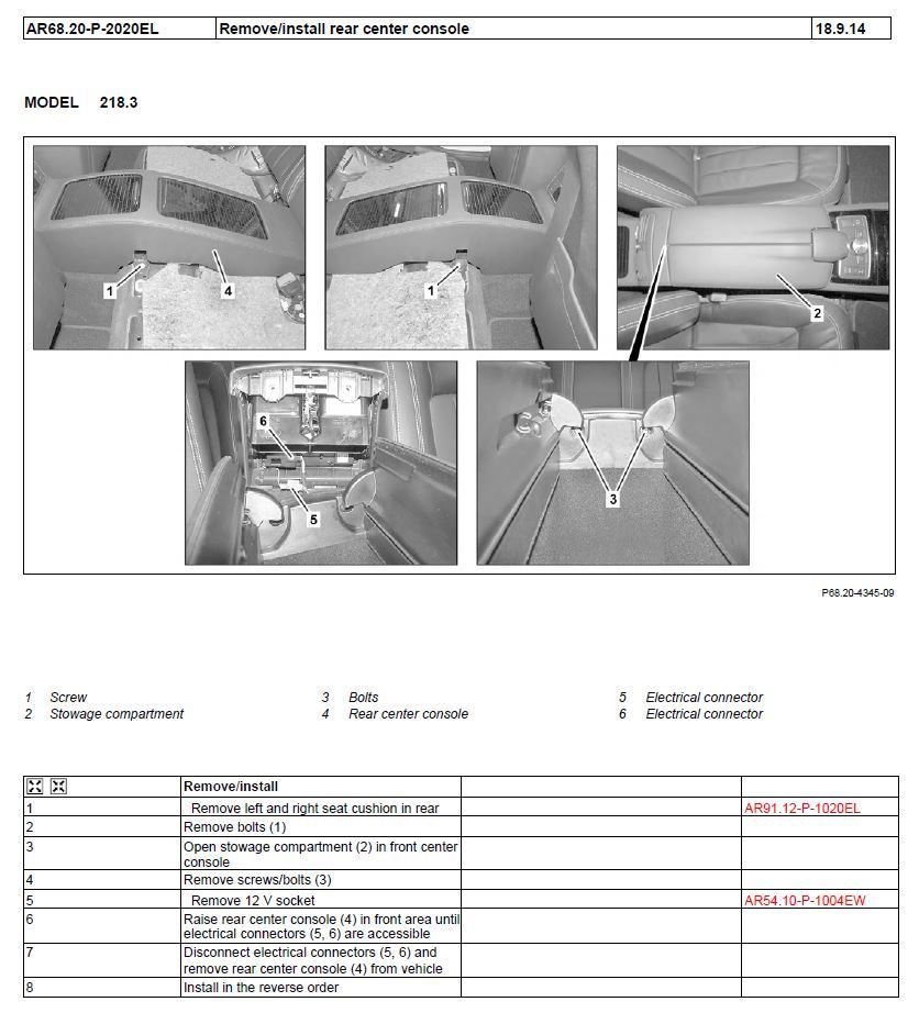

Hi everyone!
I recently ordered a complete interior trim kit off of eBay to switch out my Burl Walnut for the Ash wood interior, and this included the sliding covers for the rear center console. I've seen a fair amount of the covers sold separately, without the entire console, so I assume it's a relatively straightforward process when it comes to replacing the covers. I know I will have to remove the console from the vehicle for this, but does anyone have any experience replacing these? I haven't found any guides online for how to do so - just on how to remove the entire console unit as a whole piece.
Any tips would be much appreciated.

Old Mar 16, 2026 | 12:18 PM
Phillip Bagshaw's Avatar
Joined: May 2018
Posts: 20
C300, CLS550
Thank you!!!!! This helped a ton, specifically wrestling with the 12v socket.
