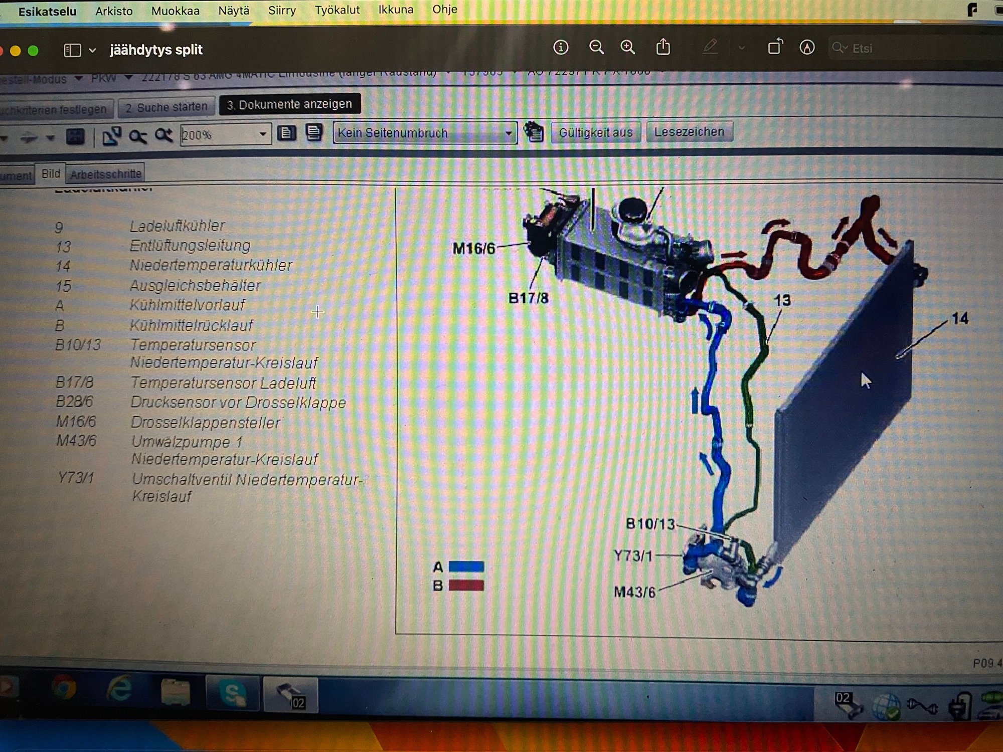

Heh we all have our own builds and of course you can do what suits you best. Im just trying to help you to see what needs to be done and what is what, when adding an extra IC HE to your current system.
Here is a picture of M278 split cooling system that you and I and M278 maybe after 2012 -2013 all have. This might clear things.
You are now updating this your system to be kind of similar that M157 + M 014 is. You can read and see the pictures, diagrams, part numbers that I list in this topic.
I have also swap the M157 center big IC HE and (can be seen on my built topic) You need a custom hose to your center HE to CWA100. All other part numbers you can find here. Or just make all custom. Its up to you.
This might help you now understand the difference between separate IC cooling system and M157 + M 014 system.
Thank you for taking the time and effort to explain everything to me. This modification will give me a good, stable IAT. Then I’ll be able to push the car clean from 100–250 km/h.
