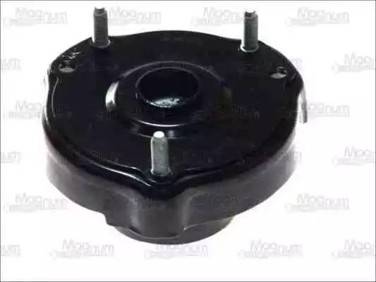

It could be this piece also: the one that keeps the spring in place. It`s a very cheap one, DYI job.
