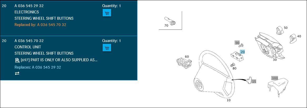

Check SCM video details module.

Thx, i found the module and orderded it second hand over the internet..
Thx for the tip!
