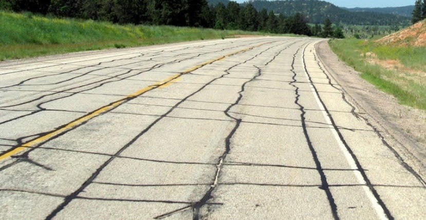

When I bought my CLS 500 I noticed abnormal inner tire wear on the rears. Put new tires on it a few months ago and took it to a local shop for alignment. There system didn’t have any info for the specs and I agreed to use the data for a 06 E500.
Put to the road and no change still pulls to the right, but my biggest concern is how it walks all over the place (Tramlining) felt in the rear when the roads are wet at highway speeds and I drive over tar snakes (Pictured Below). It causes a significant loss of control. Any ideas as to a solution… air ride delete conversation so I believe I need to factor in ride height and install a camber kit for the best results...? 285/35/18 on the rear and 225/40/18 up front.
