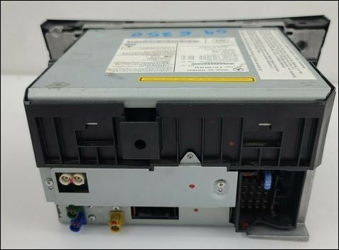

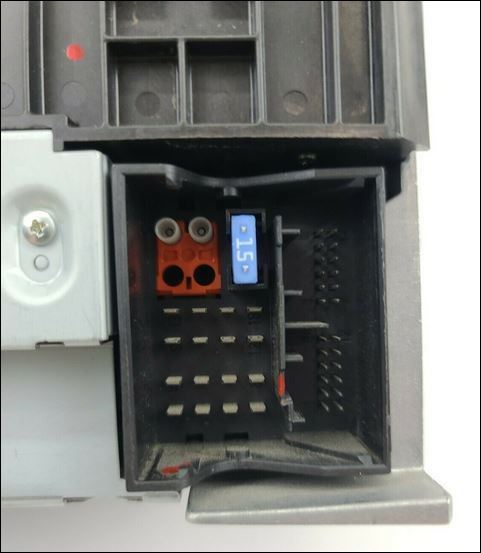

Your radio should also have a fuse on the back. Sometimes when jump starting this vehicles, this fuse pops. Specially if the key was on during Jump start.
