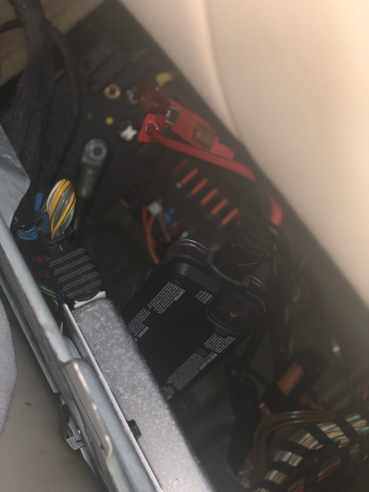

Well my battery died the other day and after stuggling with a jumper box I was able to get the car to fire up and take the battery out of the trunk.
I took the battery in for recharging at the auto store and the the trunk closed while I was gone
Now I can’t get the car to power up with the jumper box anymore I believe since the battery is no longer connected in the trunk.
I tried the fuse box jump, tried putting juice to the alternator with the jumper box but nothing works.
I resorted to ripping out the psssenger floor board and looking for the power connections under then and I think I see the correct got and ground wires but nothing happens
Please I am in desperate need of help!
I know I was jumping the wrong wrong wire but is the larger one the correct wire and should it power up the car immediately or will it take a while?

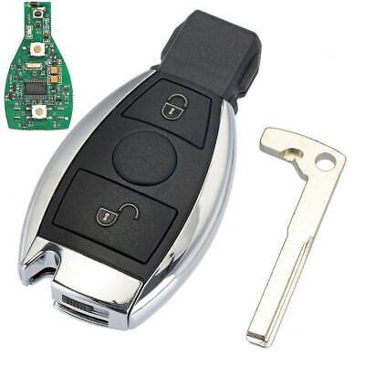

there is a little tab on your keyfob, press it to the side and you can slide out a physical key, under the trunk lid there is key slot. turn that til you feel it pop the latch and the trunk will open without battery power

you can see the little slider release tab on the bottom in this picture. you simply hold that to the side and the physical key slides right out
