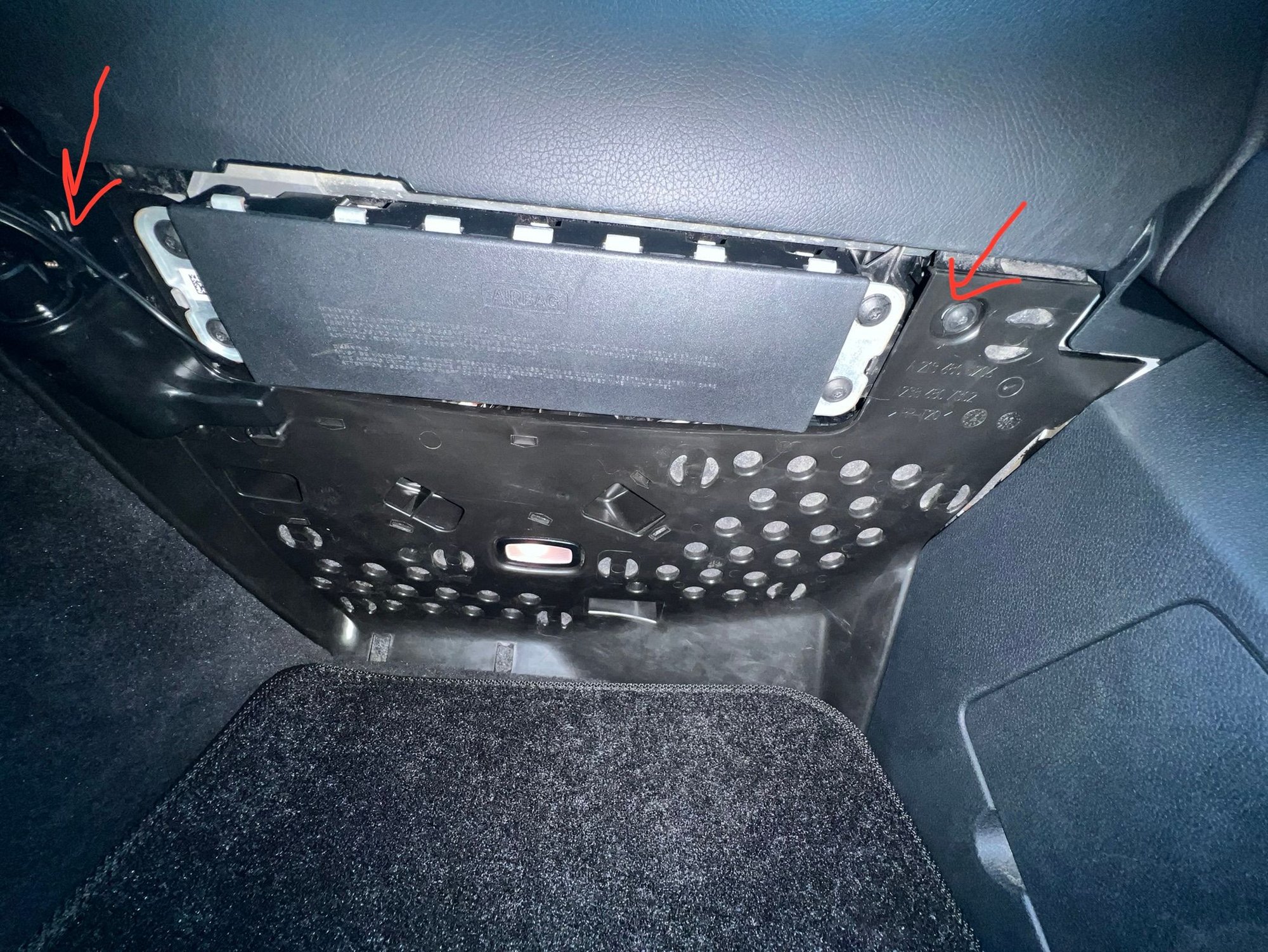

I have been looking for video and threads on X253 and W205 about how to replace the cabin filter under glove box. But it doesn’t look familiar.
Does any one have idea about how to remove the panel? I’ve tried to remove screws at right side and also the other one on the top of 12V connector, but it still tight on the left side. I’m afraid of breaking wires or airbag.
Thanks a lot.
Update: There is another screw under 12V socket. Just remove it and you can tear the panel down. And also you might need a Y shape tool to remove plastic button which is not able to remove by hand.
