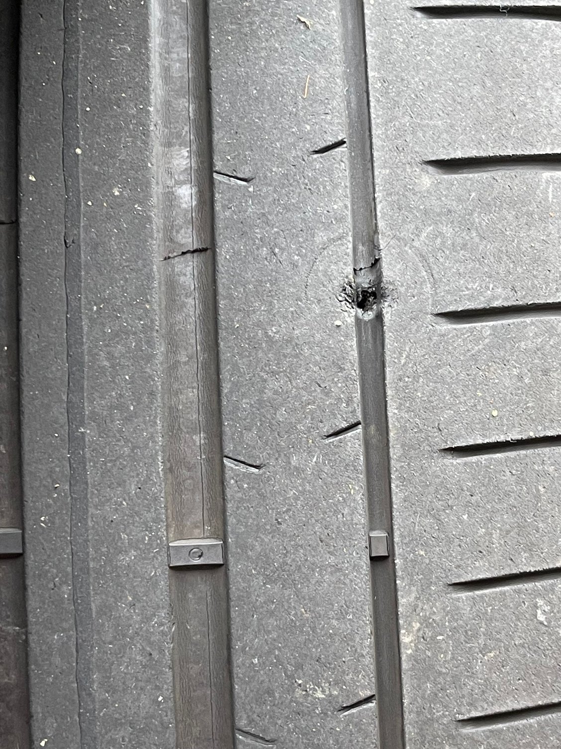

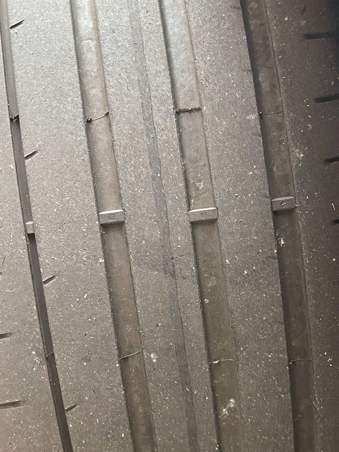

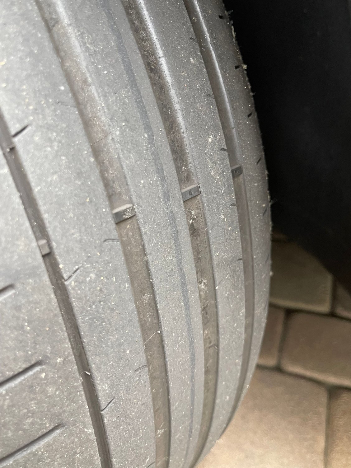

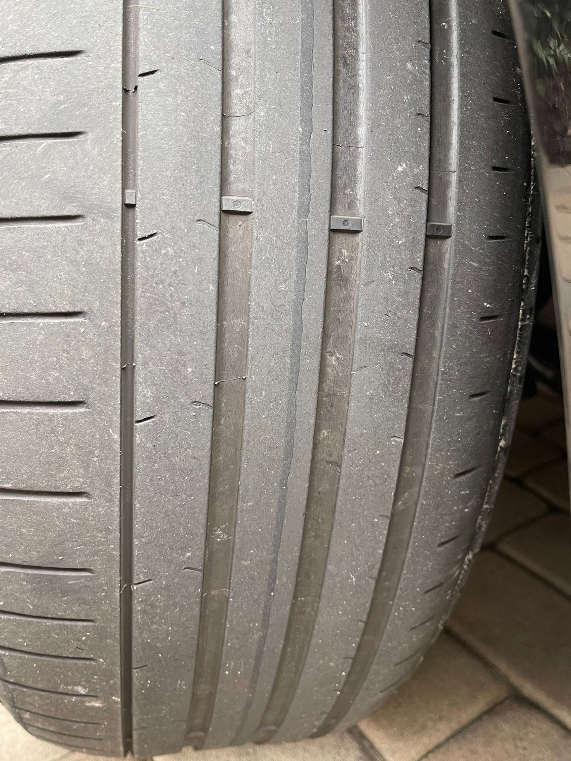

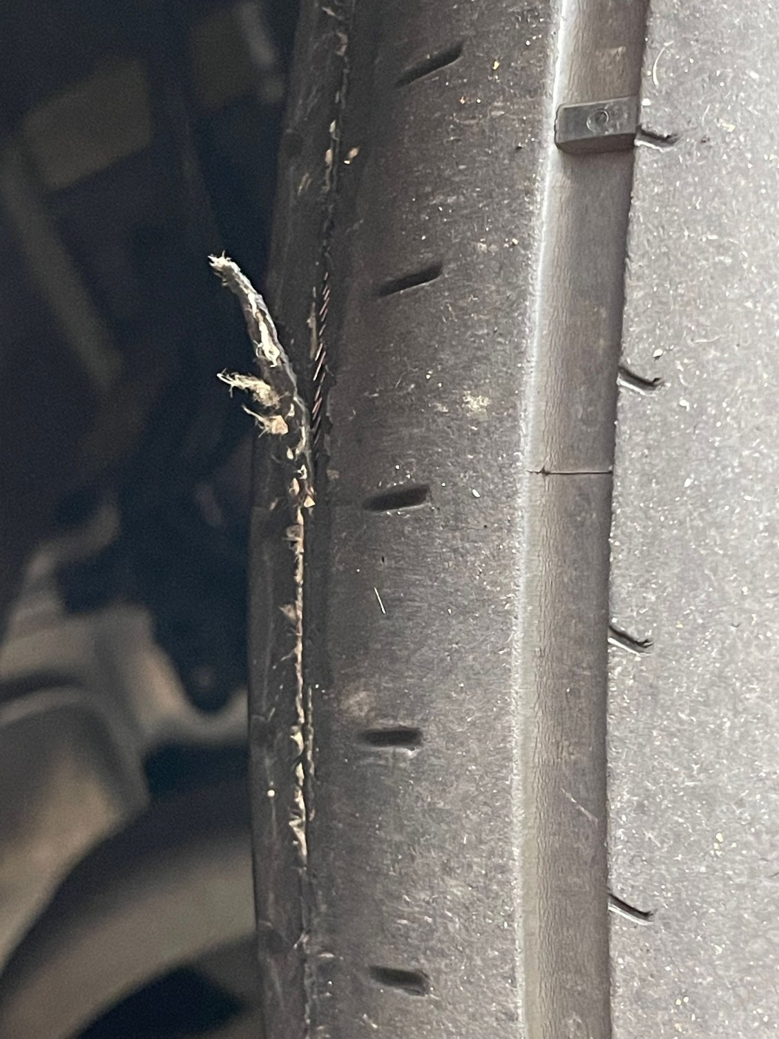

Just replaced my 20" OEM Pirelli P Zero Run Flat tires
got 5.5 years(14,000 miles)out of them. 2019 CLS 53 AMG
Yearly alignments and constant pressure checks and pothole and rough asphalt avoidance best I could.

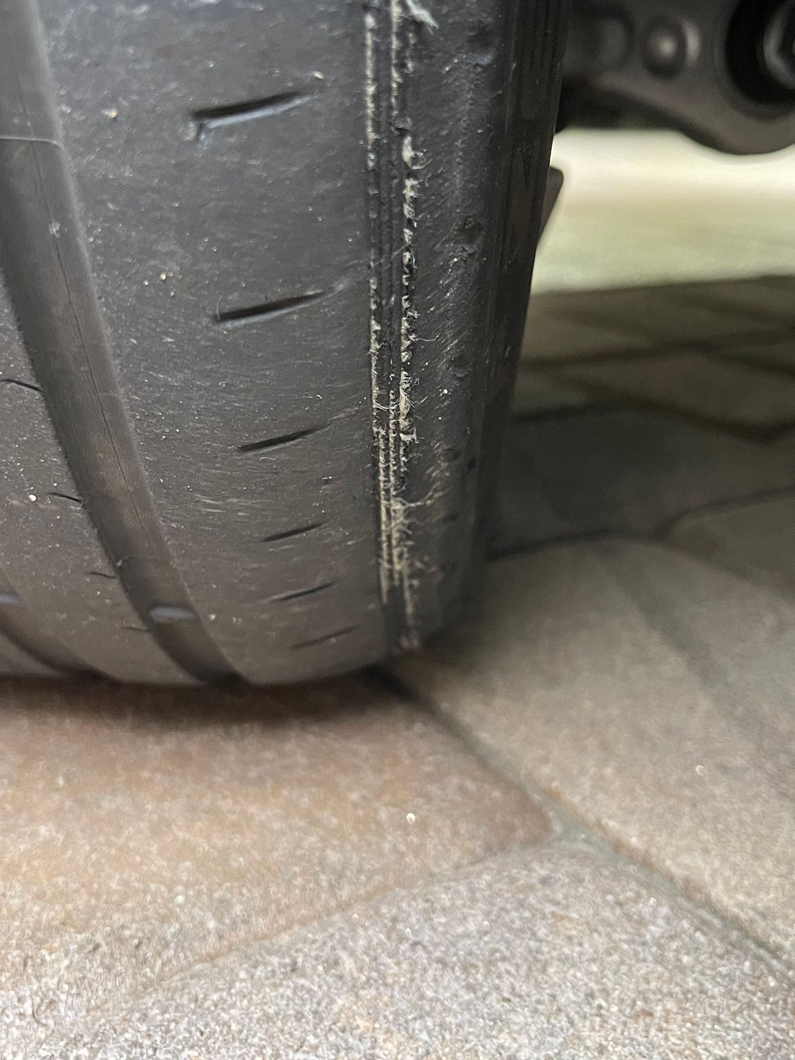

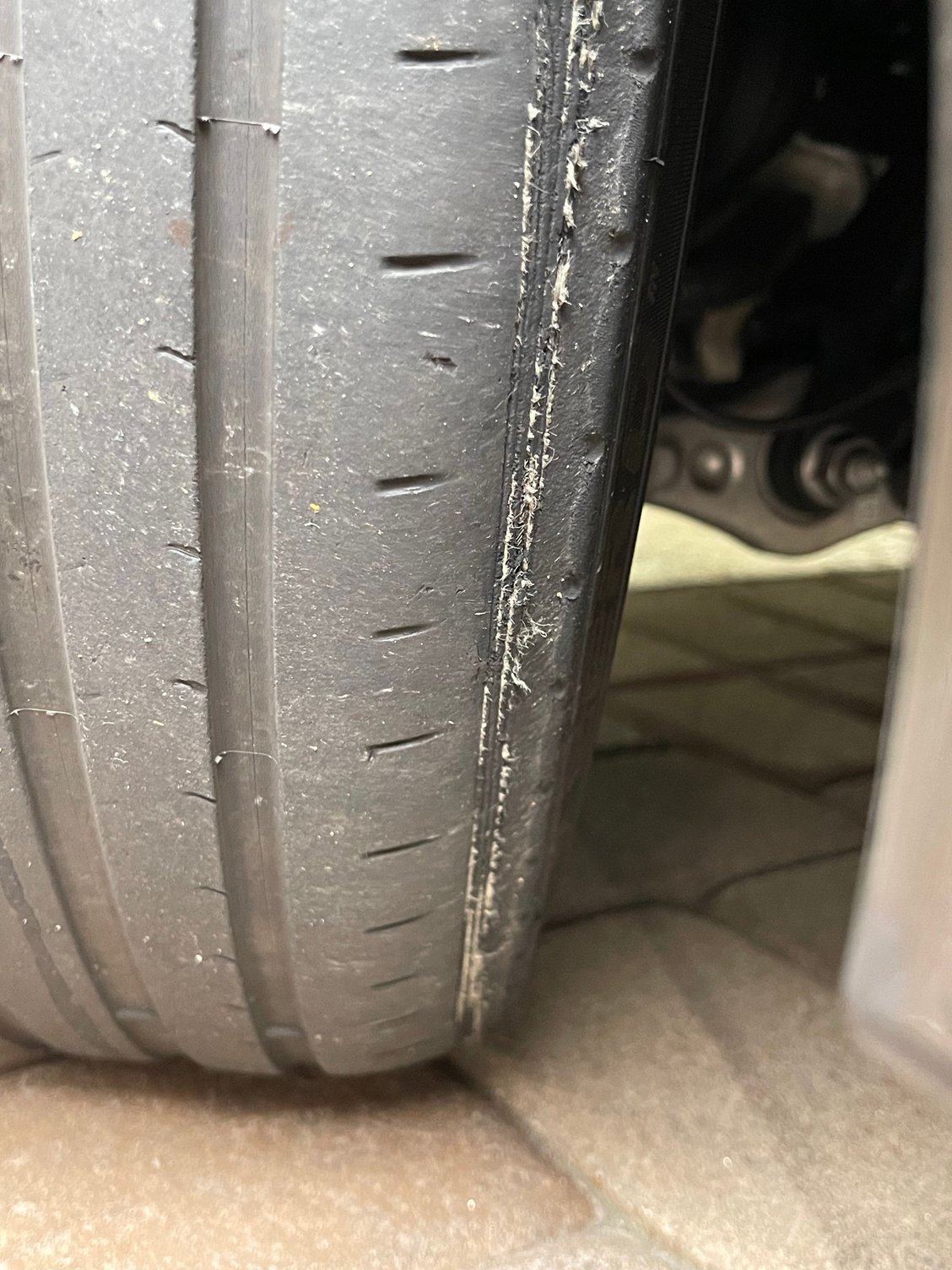

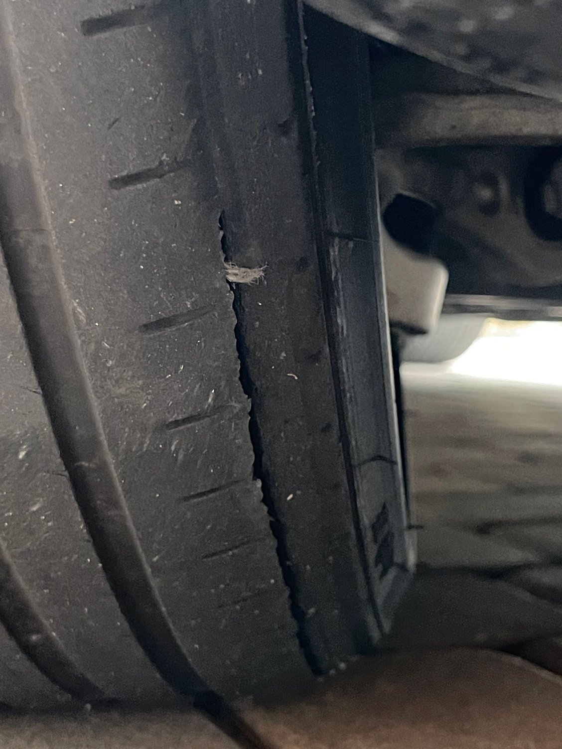

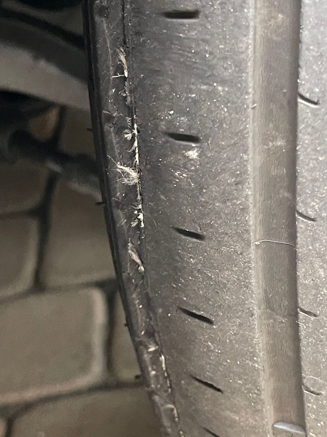

The front inner treads shredded at 14,000. See photos.

Because the Summer OE run-flats have a much stiffer sidewall, that's probably why the All-Season go-flat Conti tires seem softer in corners, resulting in more "leaning."
If you want to go back with Summer run-flats and don't want the OE Pirelli's, maybe a good option would be the Michelin Pilot Sport 3 ZP.
Compared to run-flats, just about any go-flat tire will seem softer. Run-flats have stiffer sidewalls in order to support the vehicle weight if the tires lose air.
Try looking at the TireRack site. They have lots of reviews and charts so you can compare different attributes of the tires you're interested in. (noise, dry handling, wet handling, braking, etc.)
You mentioned yearly alignments were done, but the way those front tires looked makes me wonder if there are worn bushings or some other wonky suspension parts.

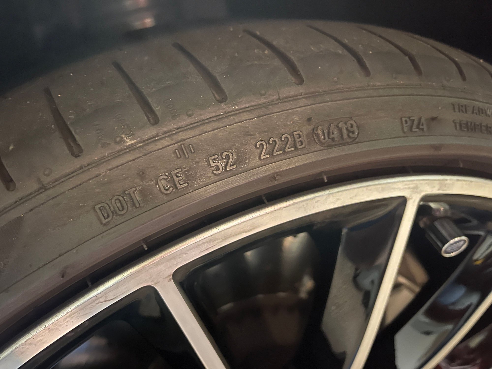

Regardless of mileage and treadwear, car and tire manufacturers recommend replacing tires at 6 years. Rubber disintegrates with time and lack of use can accelerate this. I installed Geolander A/Ts right after taking delivery of my '19 G550, and despite the mileage (about 24K miles) and remaining tread (8/32 versus 12/32 new), I plan to replace them at the end of summer.

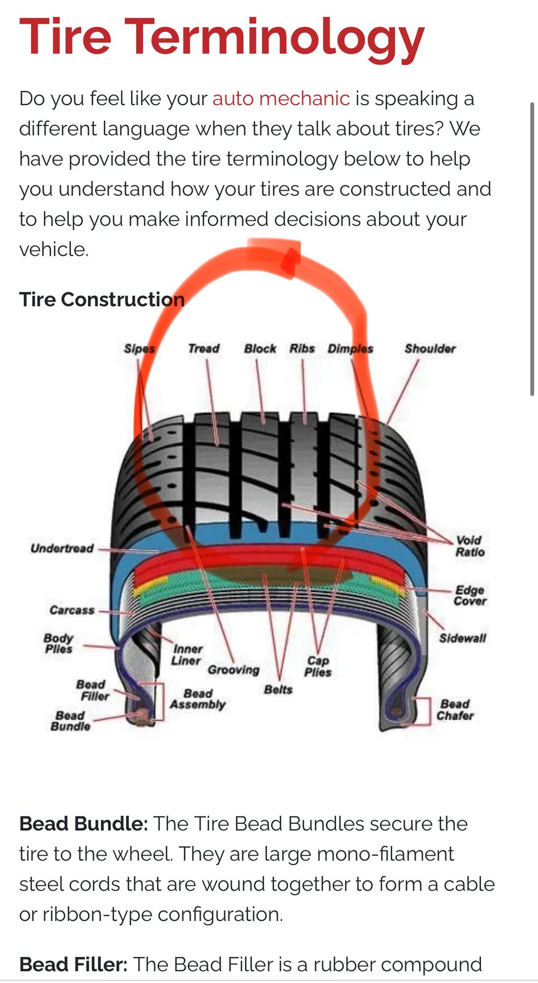

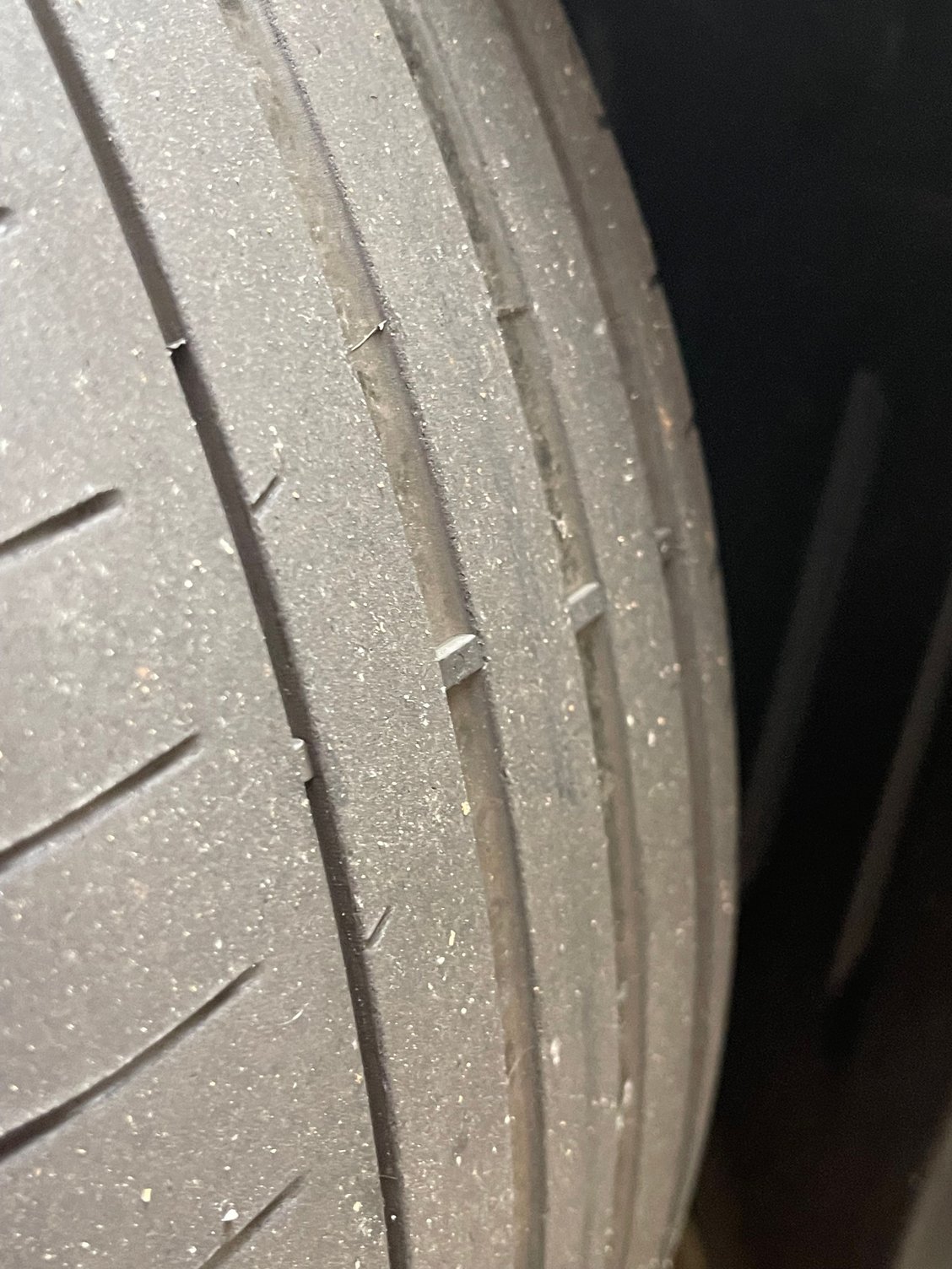

Do run flats have stiffer tread areas that I circled?
