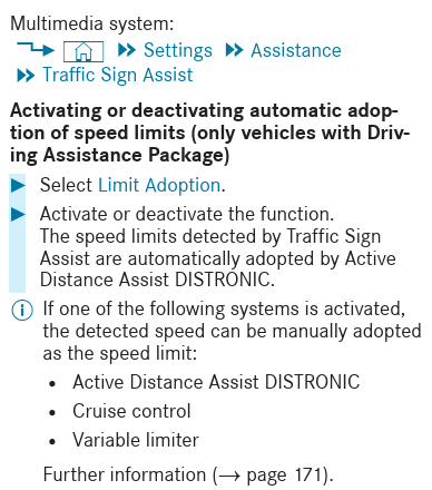

The car does not suddenly accelerate or decelerate based on what it thinks the speed limit is. It only does that if you are using DISTRONIC and you have the automatic speed limit adoption turned on. This can be turned off in the settings. I've turned this off a long time ago, because even if the speed limit info is working most of the time, it isn't foolproof, so there's always a chance that it gets it wrong. Instead I manually adopt the speed limit, which you can do by pressing RES while DISTRONIC is active. The setting to turn off the automatic adoption of the speed limit is found under the Driver Assistance settings in COMAND. Keep in mind, all these are only driver assistance features. You must remain vigilant and expect that they can fail at any moment and take control if they do.

Thanks, but I know how to activate/deactivate the Distronic, Steering assist, HUD, etc. I paid for these options on my loaded 2020 CLS450 (MSRP about $93K) and I expect them to work as intended. There is no excuse for corrupted software and no excuse for dragging the feet to fix it. I have been waiting almost 6 months for a fix. This CLS is my 9th MB (incl four S-Class) and likely my last one seeing how MB is going downhill.
