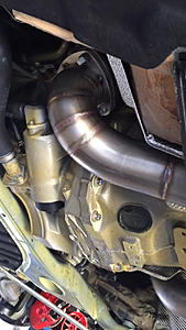

I have a custom downpipe configuration right from the turbos and it was done at R1 Motorsports. We did not have to remove the driveshaft as I did not want such a laborious headache, so it can be done but you have to have an absolute pro working on it. When I brought the car back to Steve at Weistec for a reflash, he was impressed with how it was fabricated. Just some food for thought.

Agree with Kegudi- the job is labor-intensive, but as familiarity and expertise around teh new model grows a lot of guys will see how it's possible. That said, it's still no easy-off/easy-on job that I'd trust to just any local/indy shop that is seeing its first one, you know?

Welding work.
