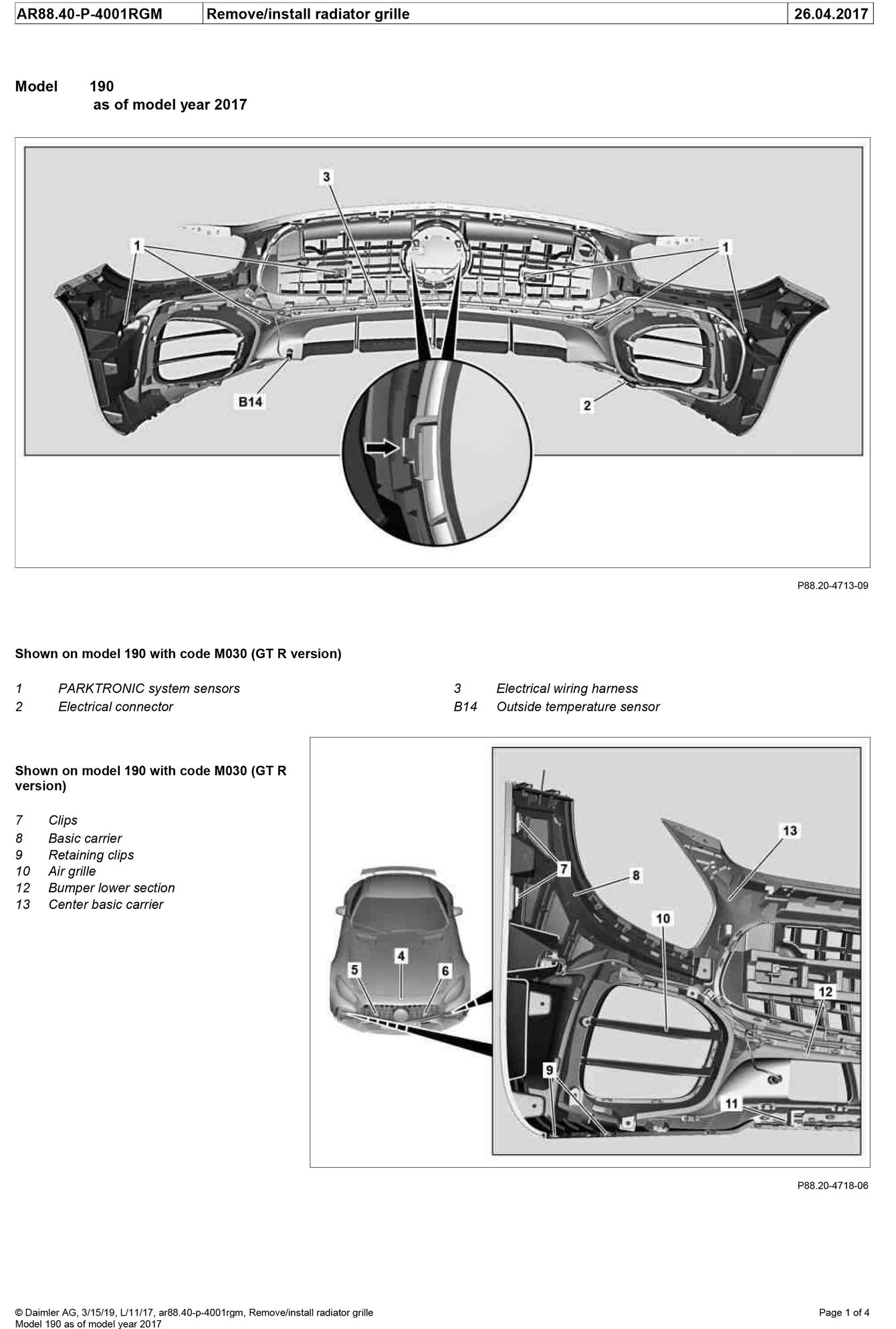

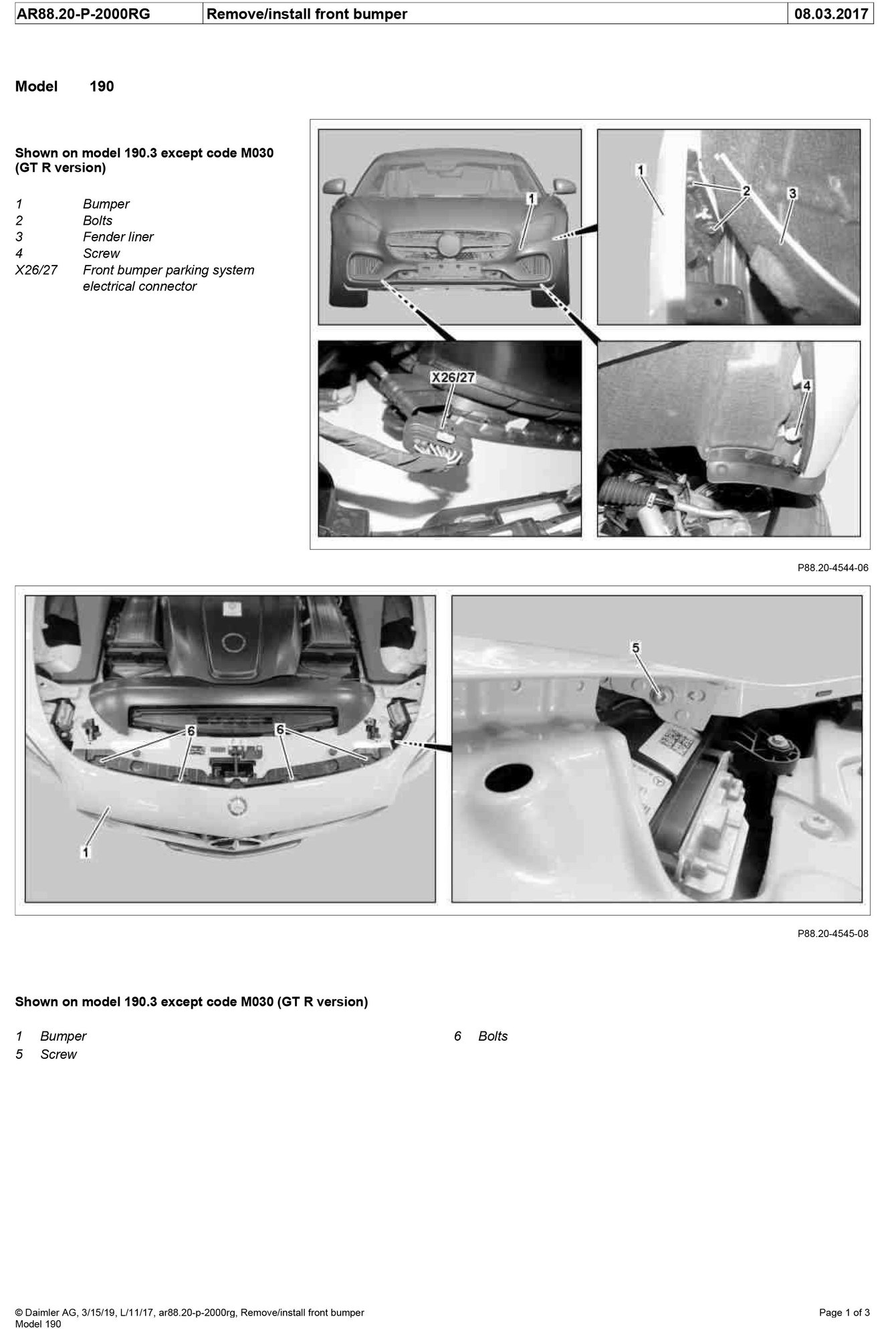

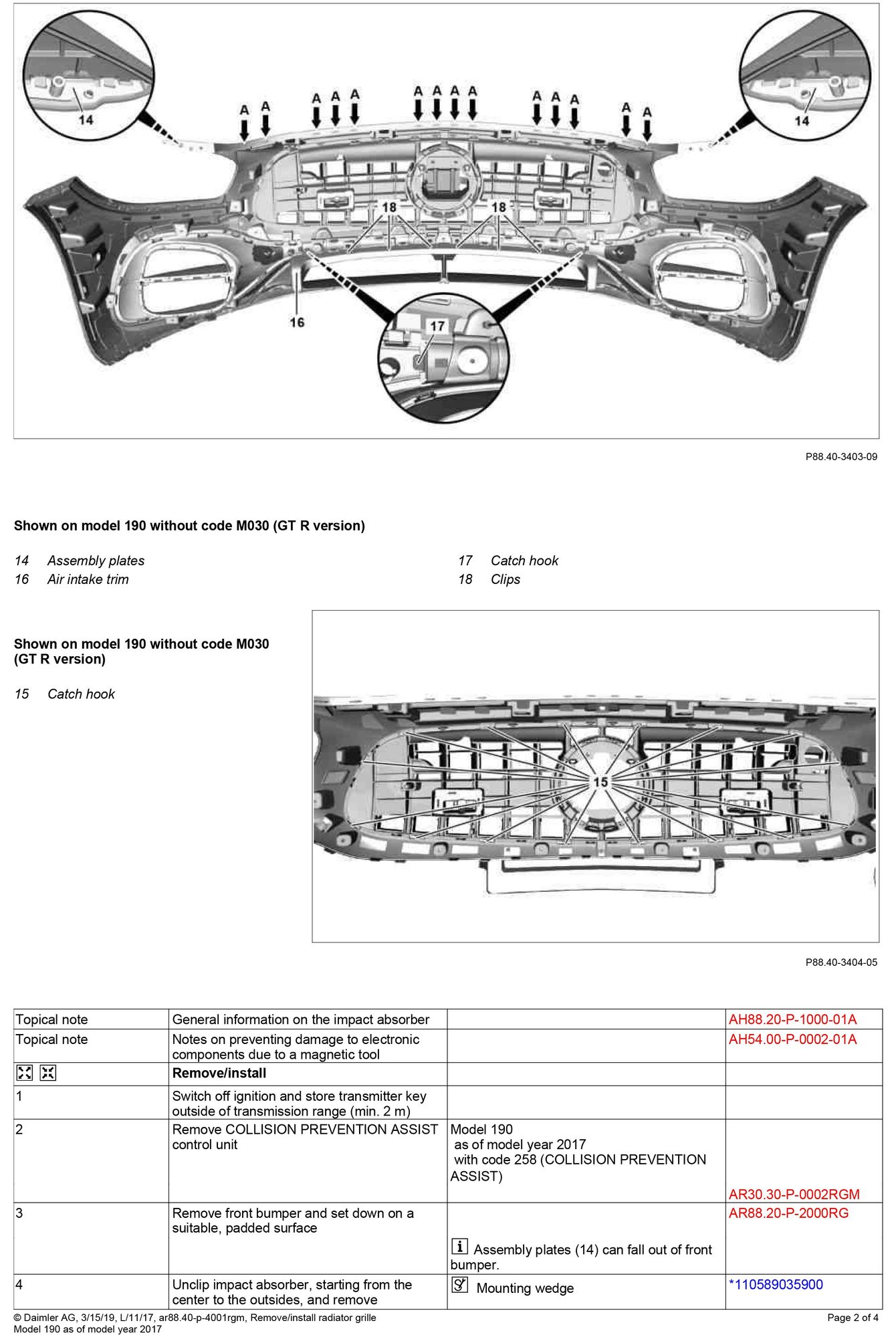

Removing the Front Bumper
For those of you that need to remove your front bumper
