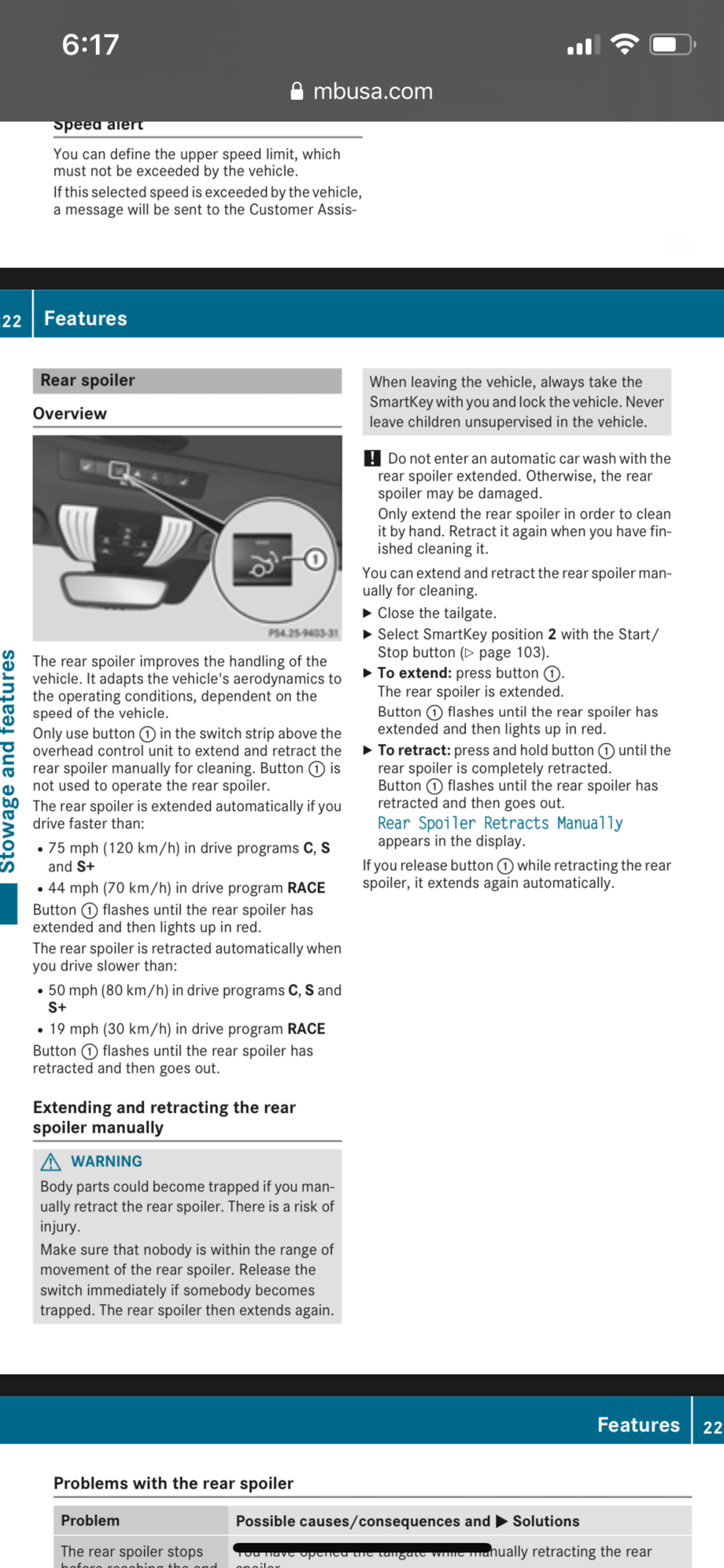

Hi, every time I lift the spoiler, it wants to retract after a few minutes. Is there any way to keep it lifted? Thank you!

Electronically no. Mechanical disconnnect but that would be silly. The only way to keep it up most of the time would be to drive in Race mode (lowers the lift to 44mph) but I think the GT models don't have that. Unsure...

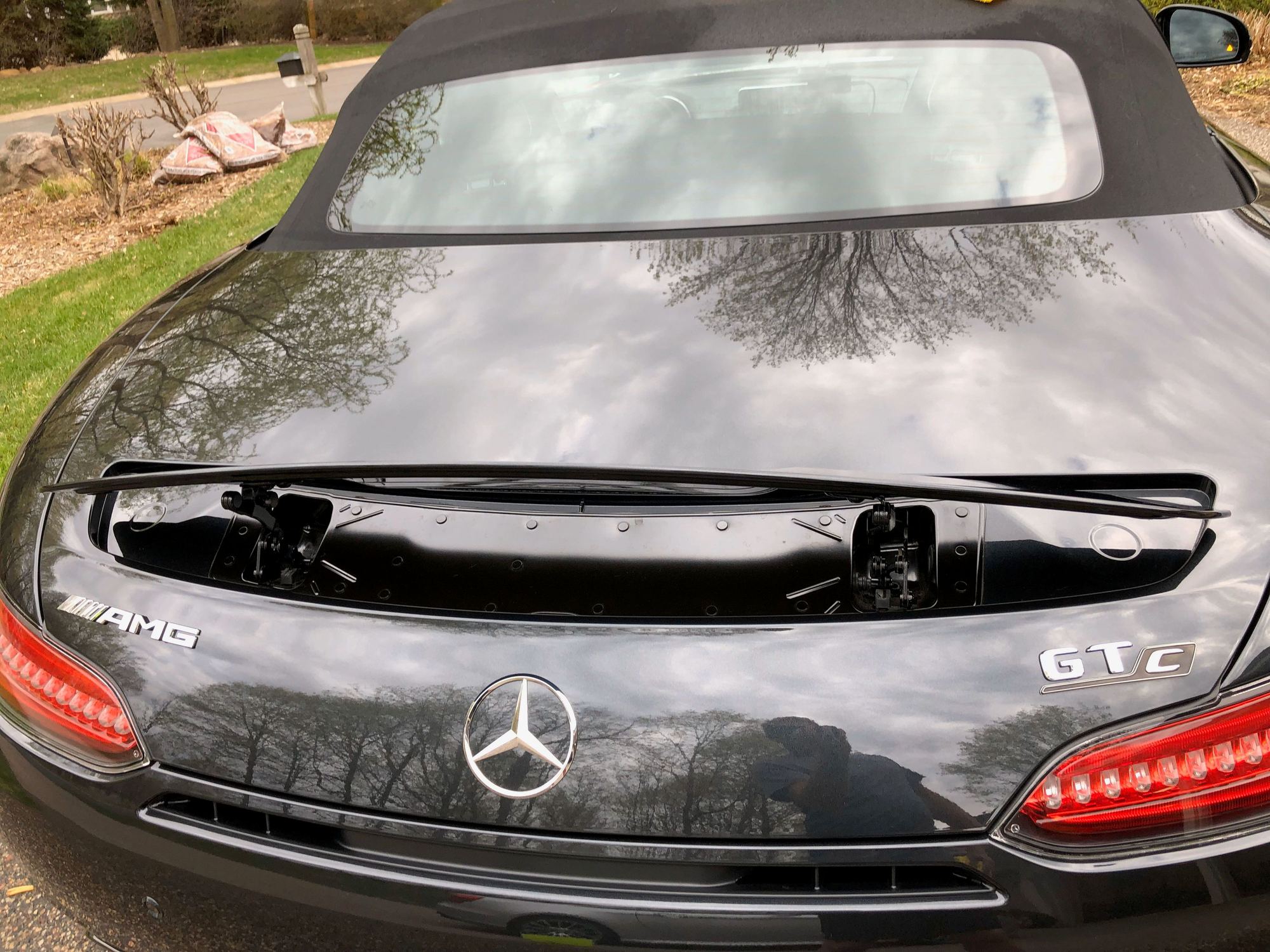

Lift the spoiler then install this:
https://ansixauto.com/active-rear-sp...-gt-gt-s-gt-c/
Old May 21, 2020 | 06:32 PM
Wolfman's Avatar
Super Moderator
Joined: May 2002
Posts: 10,546
Likes: 3,678
From: Land of 10,000 lakes
Very cool if this works keeping the spoiler in the up position.
I personally wouldn't it because I don't think it looks good as it exposes a very plain looking lift mechanism and plain black metal plate. Our car is magnetite black so its not as obvious but I wonder how that looks on a different color car. For anyone with a coupe, does the mechanism look the same?
