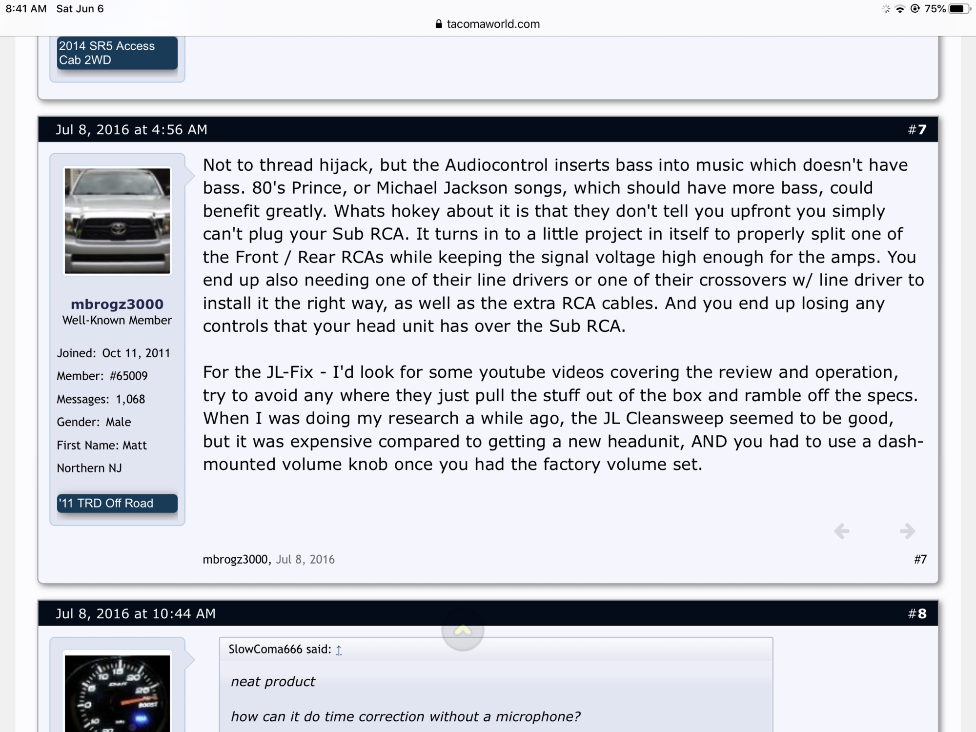

Is this the same As that audio control? It does have a sub out. https://www.google.com/url?sa=t&rct=...1mIVUYTzSVL93v
I did read this. No idea if it’s accurate.
