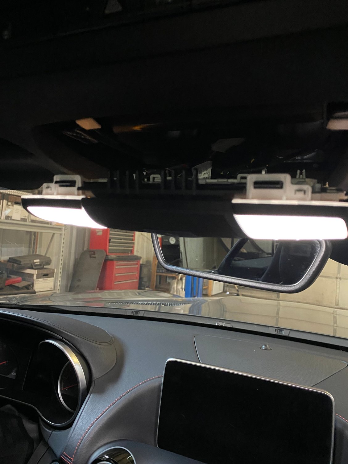

If anyone was wondering in how to install these dome light bulbs, the whole light console just pops out from the back and hangs there once you pry the tabs in the rear corners.
Then the bulbs are just unscrewed and install the new ones. Sorry if the pic is not that great, it takes less than a minute to do these. Now on to the flood lamps.
