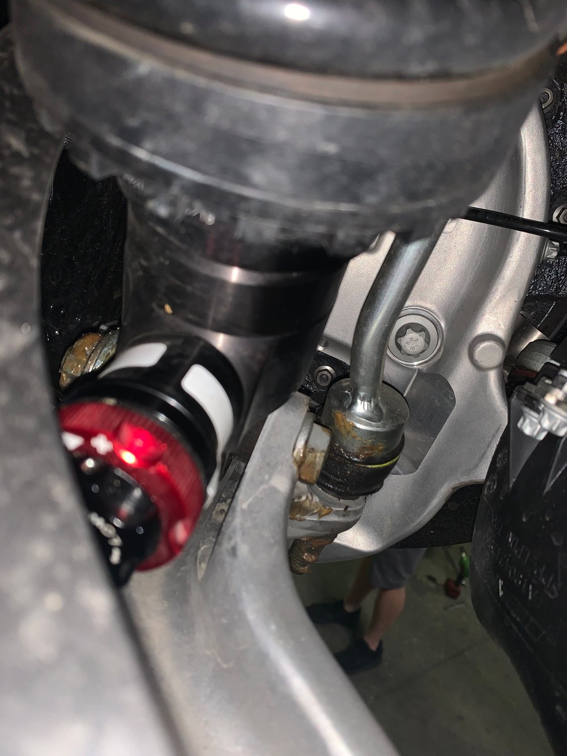

Where did you find the compression knobs?

The compression knobs are on the bottom inside of the shocks so you will need to be under the car to adjust , on jack stands or up on a lift .
View from inside looking past front suspension and around the brake duct . G

thanks. I’ll get mine up on jacks early next week and take a peek. See where I’m at.
