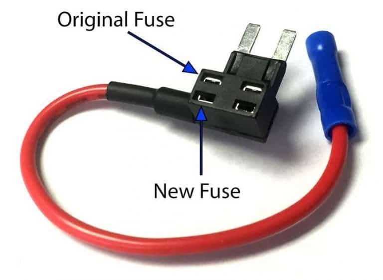

One of the "go to" Switched accessories I have used on other cars is windshield wipers. I use a Tap A Fuse. This allows a fuse protected line that might be a different amp value than the wipers.
I'm assuming you're looking for a switched +12v and not some other voltage such as +5v.
In my GT, the wiper fuse(s) are 10, 13 in the front passenger footwell. 10 is a 30 amp to run the motor, 13 runs the pump and is 7 amp. You shouldn't need the high amperage side for a camera, just tap off the pump side (fuse 13). A 7 amp feed is going to easily handle 10a, but guessing your camera is going to be more around 7a or 5a, If you do this just remove the fuse in the #13 slot, replace with the tap a fuse, put the 7a fuse back in the first slot of the tap, and the recommended fuse amp of the camera in the second slot. Run the camera +v to the red wire coming out of the tap a fuse and a ground to ground.

Thanks mate, I've used the tap or add a fuse before and they work great. The camera is 5v and 2 amps so I've installed a small water proof USB connector near the battery in a vented case so the camera is working and I can touch the relay engerizing wire to the battery and the camera only powers up when the relay is energized, so basically whatever I tap off will just be to turn the relay on, the camera is getting power directly from the battery instead via the relay. What I'm wondering is how do you run a wire inside the cabin on the passenger side, is there a gromeet that easy to push a fish tape through or fish pole, or do you need to make a new hole and grommet into the passenger side ?
