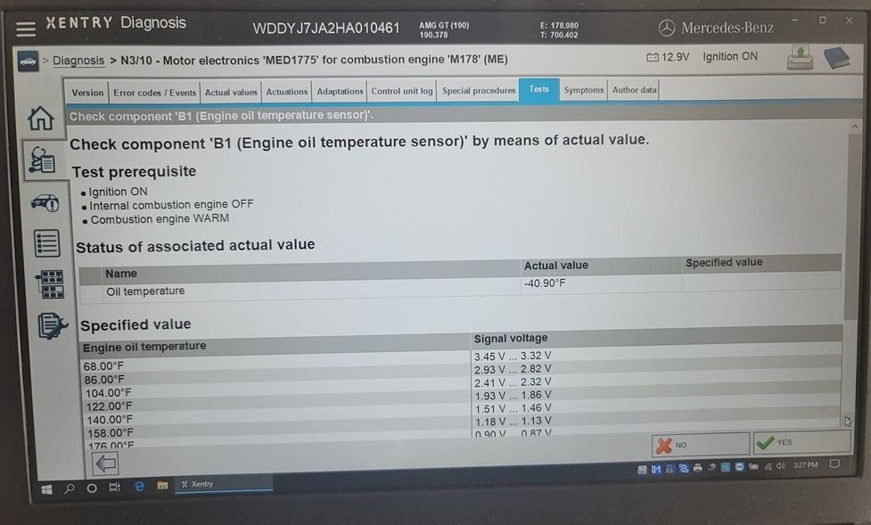

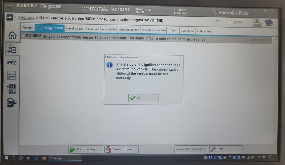

My engine oil temperature reads -.-F prior to engine start and shortly after jumps to -40.90F - I have replaced the sensor in the engine block and still have the same readings.

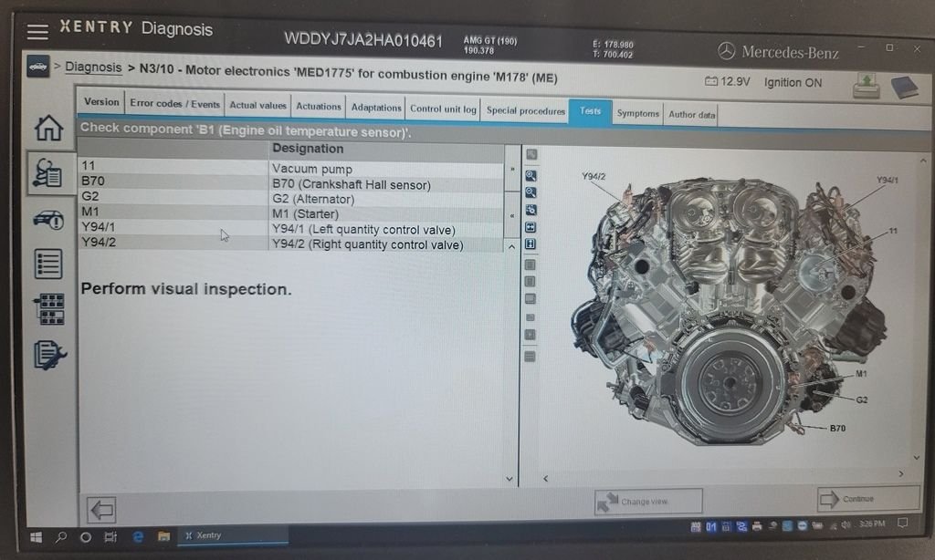

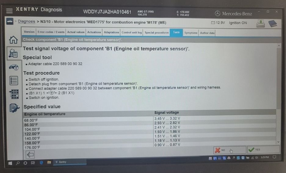

I'm searching in WIS/ASRA for the right wiring diagrams so I can trace all the related wiring and check voltages.
I just found in Xentry (see attached) what appears a sync procedure for the sensor and cluster gauge?
Anybody here that has a similar issue and got it resolved?
