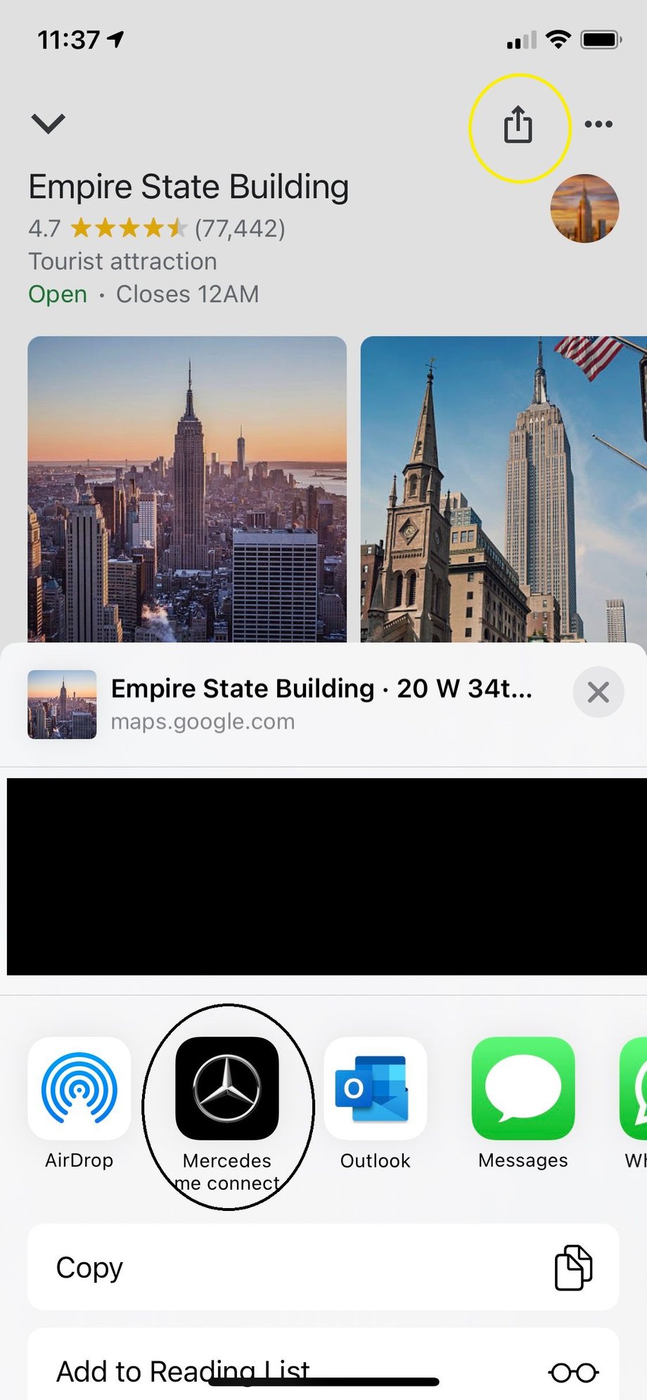

Just the Mercedes me connect app, but you don't actually have to open the app. You can share a destination from Google Maps, Apple Maps, Yelp etc. and select the Mercedes Me app as the share target and then confirm with send.
In Google Maps for example just tap the share icon in the top right corner and the Mercedes Me app is one of the options to share it to. You may have to swipe left and tap "More..." to see the app. You can move the apps around, so you see the ones you use most often first and don't have to tap "More..." every time.
