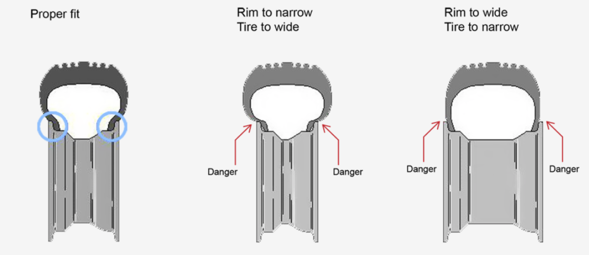

With the tire width 275 on front and 315 on rear, itīs not a problem with the original 9.0" / 11.0" rim width?
Sure, you can assemble them, but know this recommendations:
275 is at least 9.5 " / better 10.0" / max. 11.0" rims
315 is at least 11.5" / better 12.0" / max. 13.0" rims
or
max. tire width for 9.0 " rims (GT/GTS/GTC stock) is 265
max. tire width for 11.0 " rims (GT/GTS stock) is 305
As I said, recommendations, have stuck to it so far, so have no experience with the extra width tires.
Best regards
Stenzel

FYI-using the Michelin Pilot Sport 4s as an example, 305/30-20 Michelin is ok with it performing and meeting its ratings on a rim width ranging from 10.5-11.5” and since the tread width is 11.2” their preferred spec (what THEY measure it on) is an 11” wide wheels. So go ahead and push that car hard on and off track with a 305 on a 11” wide GT/GTS factory rear wheel…
