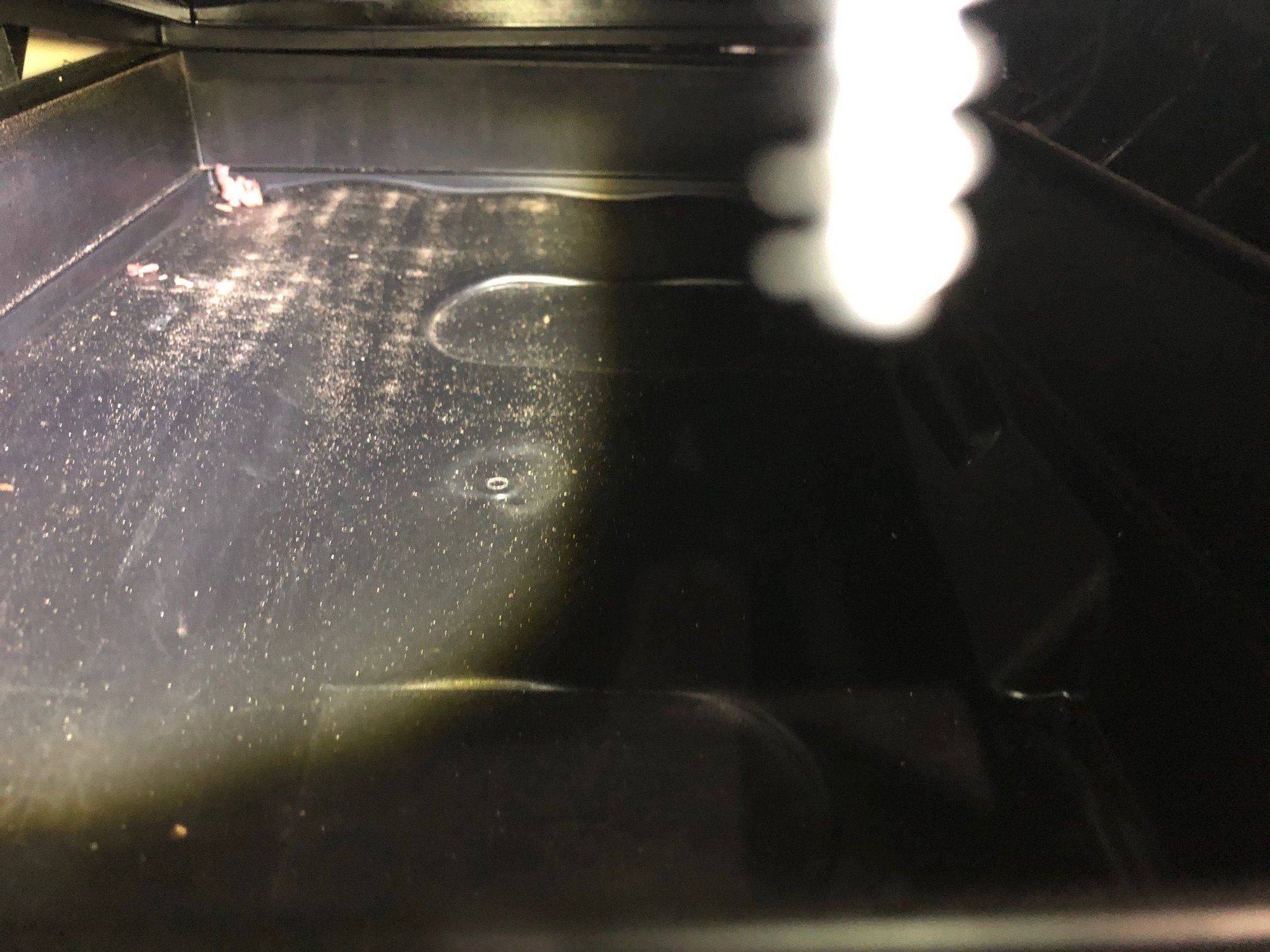

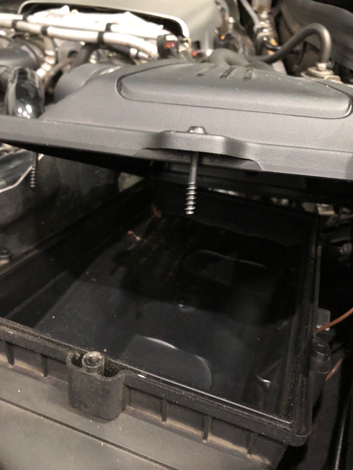

The points I made above about the factory design that help keep the filter from contamination and perform much better over time than the aftermarkets do was important enough to do a simple demonstration for you. I spent five mins pulling the left side filter on my car and the pics below should be proof points for anyone.
I JUST changed my air filters in July, so there are only 3 months of street use. In the first pic you can see where/how the factory air filter fits into the air box. The topside of the air box is clean, the bottom side of the air box is dirty. The dirty side of the filter faces DOWNWARD.
In the last pic I want you to see the debris, including some large pieces that are inevitably going to get sucked into any car in most any environment. The debris you see here is NOT clogging the factory air filter or reducing air flow. Think about where this debris would be right now in an aftermarket setup, pick any of them, look at their pics on their sites, follow the air flow and debris. Is it in the filter blocking airflow? Imagine what the third pic will look like after 24 months.
One last point about filtration - filtration surface area. The accordion folds you see in paper elements (and in the wet filters), if opened up and laid out on a table would represent the sq.area of filtration available to allow for airflow, and to retain dirt particles which we know will eventually reduce or inhibit airflow. Simply, the larger the area of filtration, the greater the airflow, and the longer the filter will perform. Here too, look at the aftermarket filters being used and compare to the filtration area of the factory one. Visual is enough here without actually having to cut up filters and lay out the filtration paper or media.
Hope this is helpful,
Acta

Great pics. Is this a function of gravity or by design??

It's the function of gravity that the designers took advantage of. I use OEM filters that are paper. Using an aftermarket oiled filter in place of the factory paper defeats this function as any dirt particles will stick to the oil then turn into a micro sludge that sticks to the filter element. The factory has it all figured out on the intake we just need to appreciate the brilliance in the design.

Insanely helpful, really appreciate you putting in all the effort! Having the dirty side down seems very clever

Wether it’s designed that way intentionally or not it makes sense to me. That and a good high flow dry filter…..

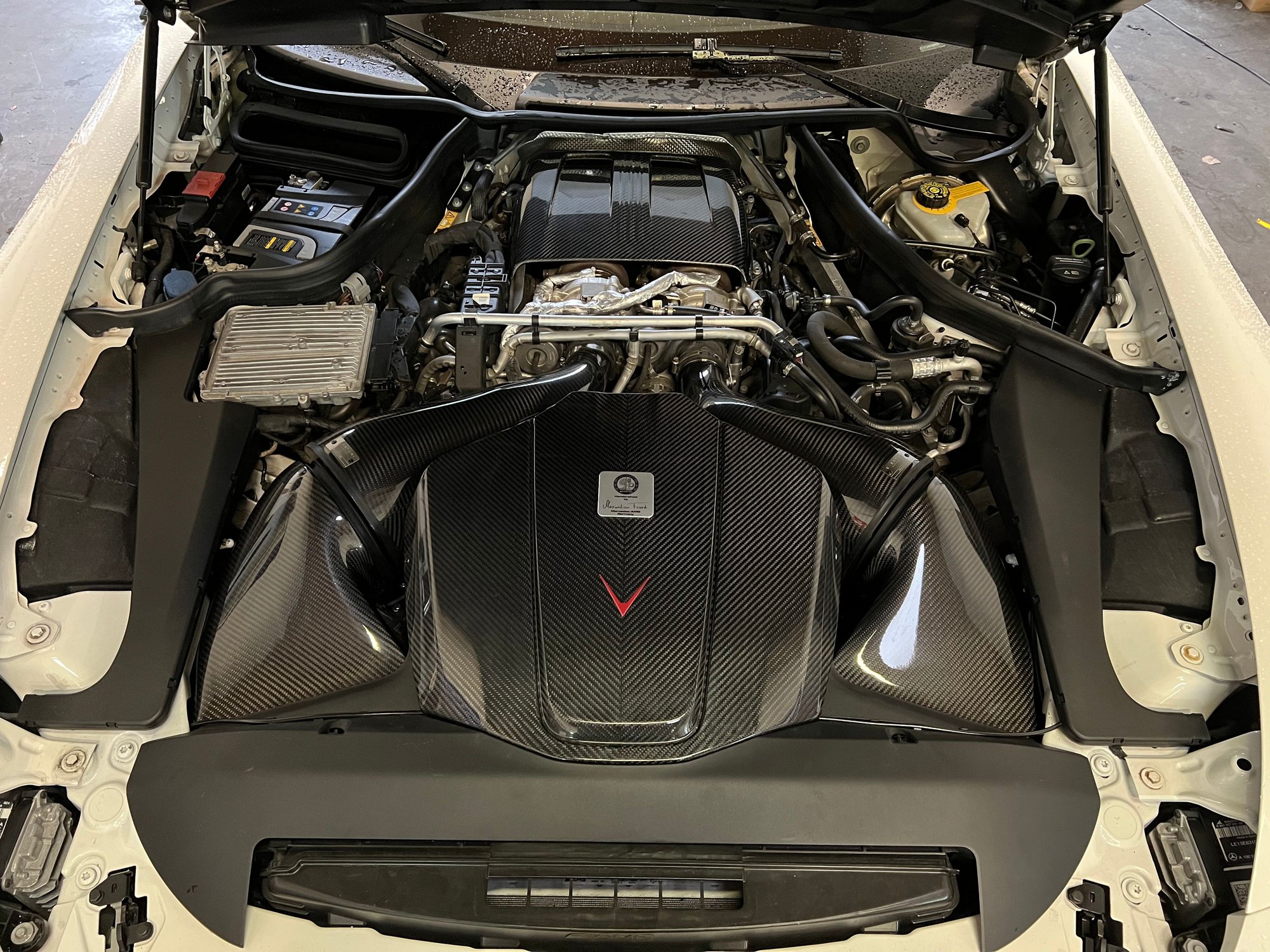

I don’t know how much horsepower I gained but the sound from the turbos, down pipes, intake and blow off valve sound amazing

That’s very pretty. Good you are happy with your decision.
