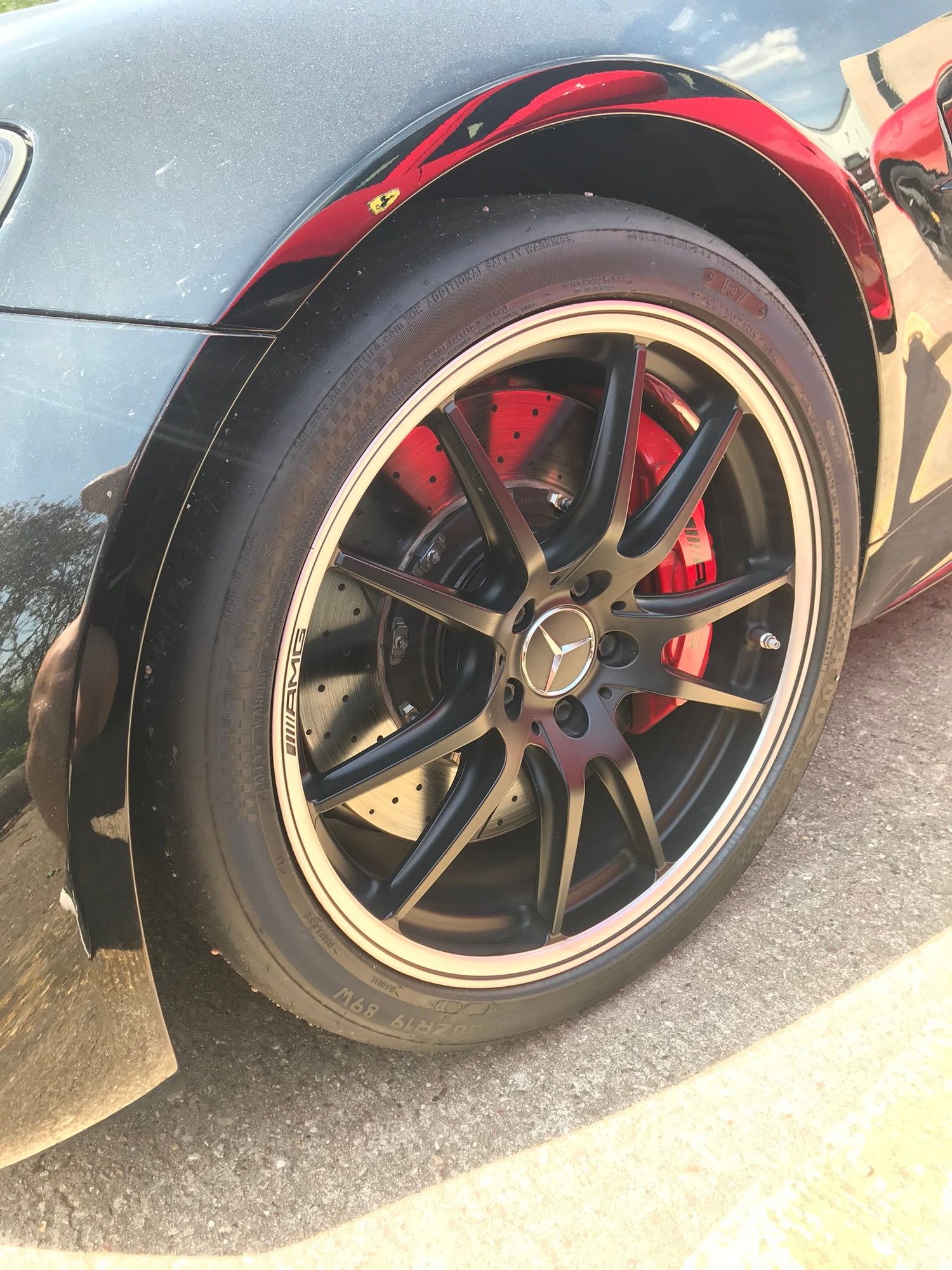

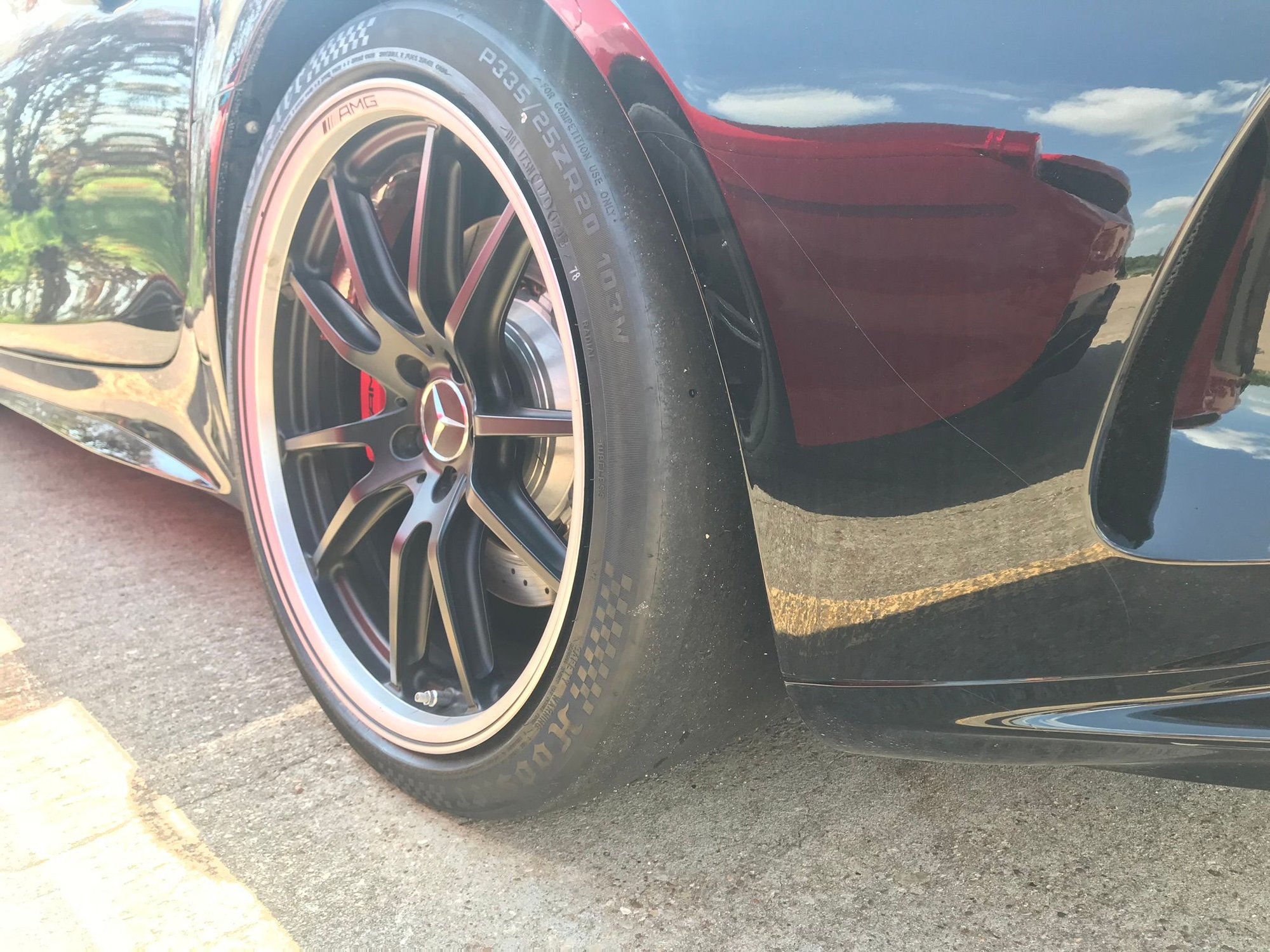

Yes. I posted this previously: https://mbworld.org/forums/coupe-roa...ml#post8428840
I fit Nitto NT01's in 315/30/20 in the rear and 285/35/19 in the front on a set of spare OEM AMG GT-S wheels I have for the track. No rubbing at all during track days, or when driving home from the track. Tires seem a bit wide for the OEM wheels, but those are the only sizes that the NT01's are available in that make sense. The 315's are good for 10.5" to 11.5" wheels, and the 285's are good for 9.5" to 11.0" wheels.
