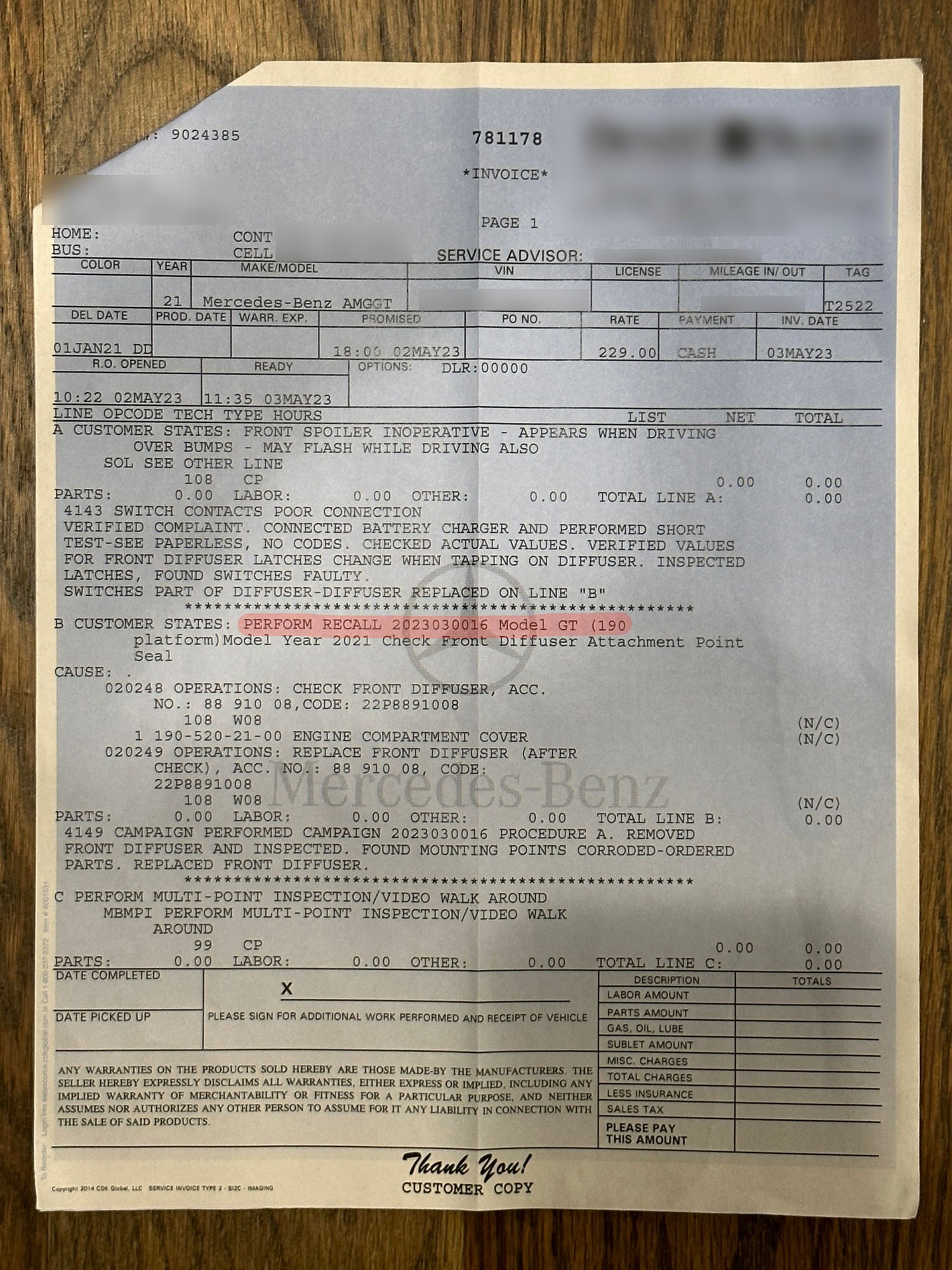

To update on the front spoiler fault issue;
So I drove the car to my local MB dealer on Tuesday morning; they got to it immediately and discovered a recall (see the picture attached) regarding the front spoiler. They overnighted a new assembly from California and had everything done by the next afternoon (I am highly pleased with the turnaround time).
I had a chance to take a picture of the previous spoiler vs. the new spoiler. MB has done a mild redesign of the front spoiler; no more air channel guides and fewer screws on both sides.
Dealer service writeup
Original front spoiler
New front spoiler
No more lights on the dash under any circumstances, and the new front spoiler slides in and out much smoother than before. I am very pleased with the service.

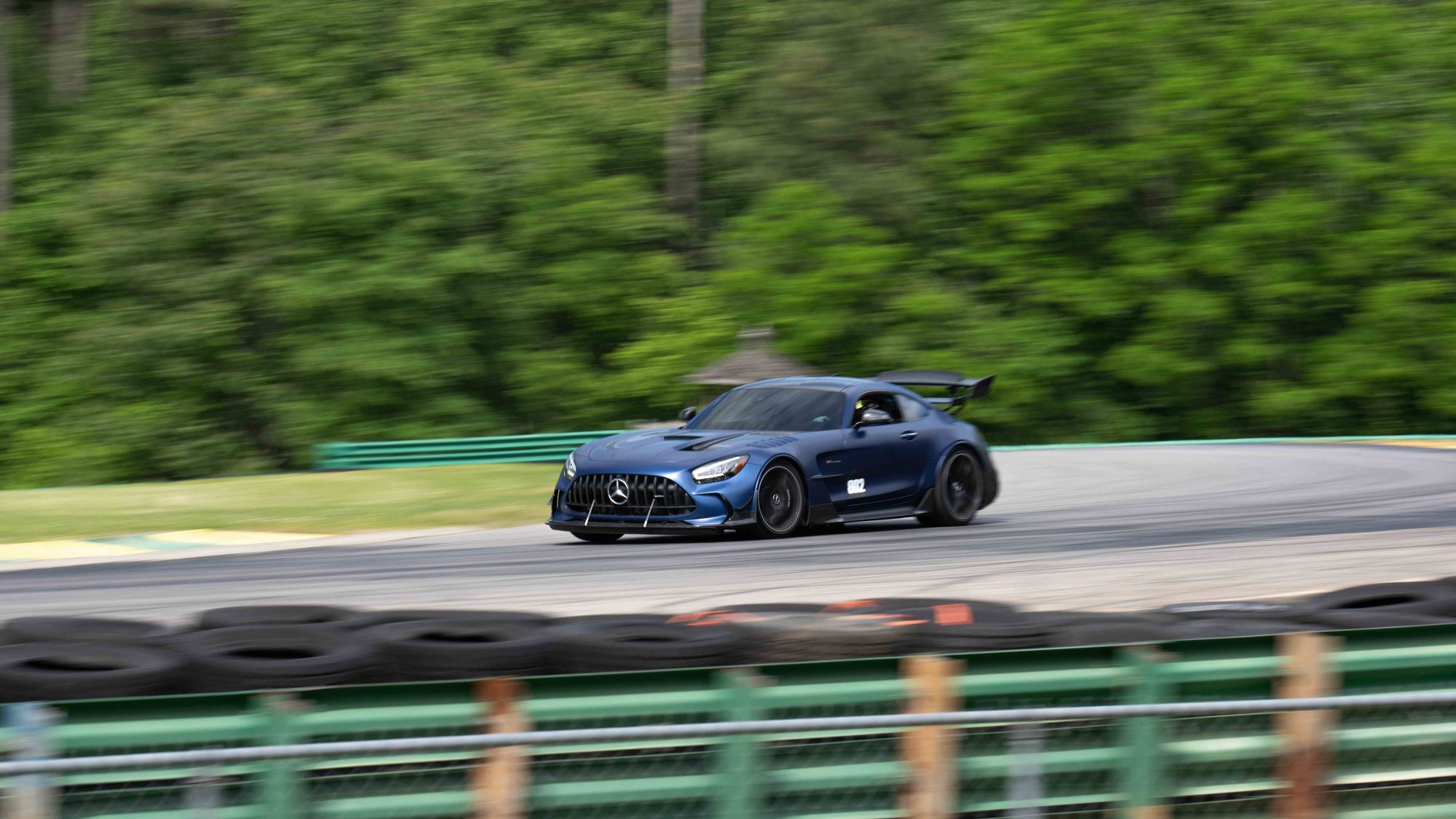

To update on the VIR event. The car was terrific and held up very well to all the abuses. Tho I did blow the AC compressor...
The car is showroom stock except for pads (PAGID RSC1) and fluids (Castrol SRF) including alignment.
I was able to lap the VIR Full Course in 1:55.38 on a set of new CUP2R's, but there's still a second or two on the table with a faster driver behind the wheel.
Here is the link to a video of the fastest session from the event.

Very good lap.
I am sure you will get much better over time as you get used to the car.
I think I saw a reference somewhere to cutting off the a/c when in competition.
I’ll see if an turn it up.

Great stuff! God, I love seeing that car used in the way it was designed to be used! lol
