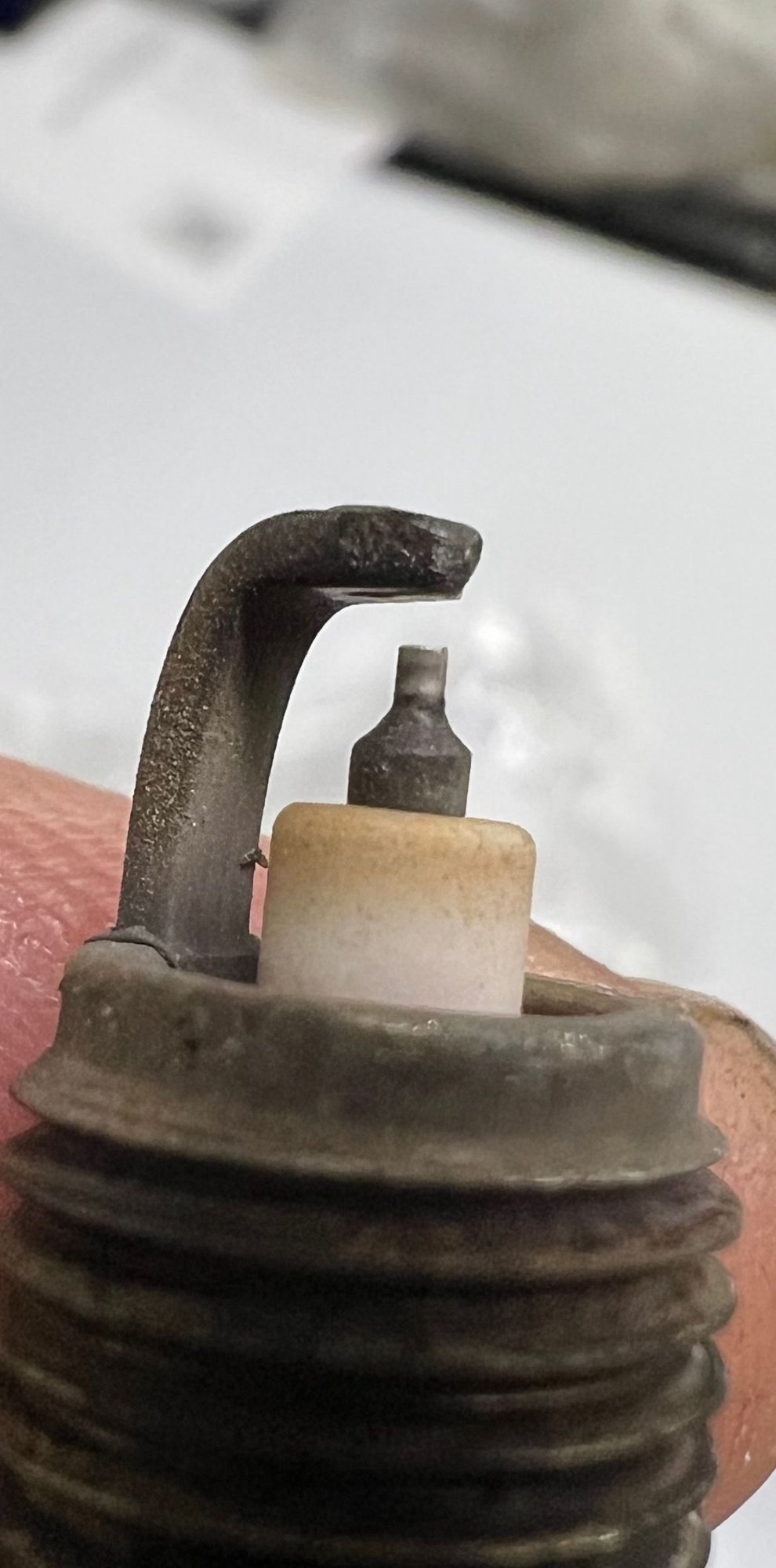

Changed my plugs. Was recommend to do every 8-10k miles with my pure Turbos , 100 octane and lots of track time.
here is an example of one of the plugs removed. Looks pretty good to me 🤷‍♂️. I’m no expert though.
Old plug.

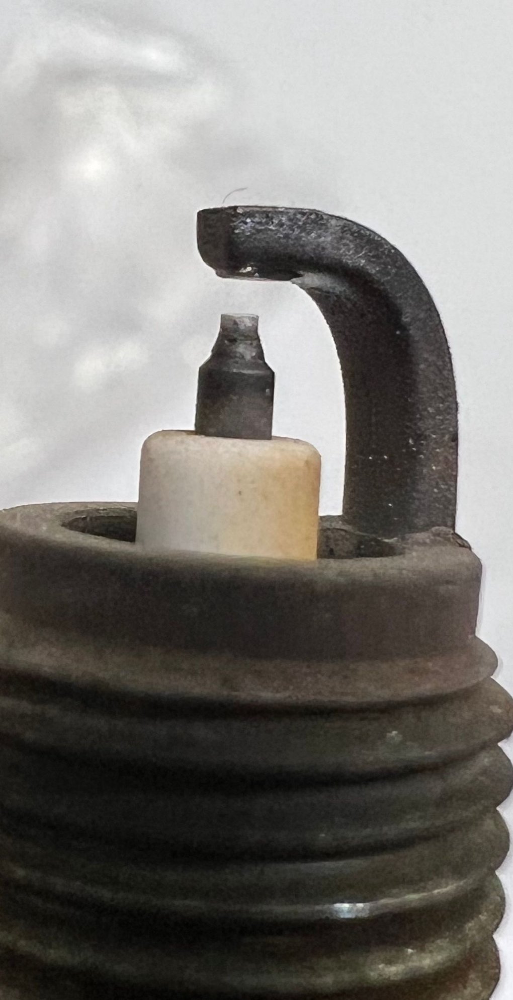

here is one from about the same amount of miles
Factory turbos and tune only.

They look pretty damn good to me, given the Pure turbo set up and you track the hell out of that thing.
I am planning on doing my plugs this winter, it will be interesting to see what they look like at 22k miles with no track just DP and Tune.
I am betting on yours looking much cleaner. Hell, I bet your engine has 0 carbon build up either.
