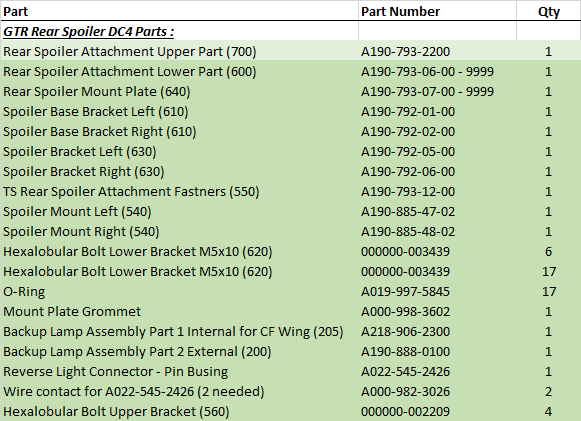

Here is the complete part list for the GTR rear spoiler/wing:
AMG GTR Rear Wing DC4 Parts list

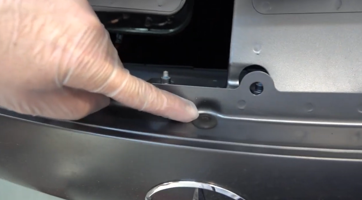

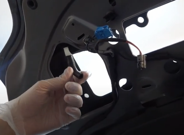

It is crucial to seal the two water drain tubes (one on the left and one on the right side of the liftgate door) that were originally attached to the wing motor assembly to prevent water from leaking into the trunk. See pic below.
However, do not seal the drain input located adjacent to the lower part 600. See pic below.
Ensuring these steps are followed meticulously will help prevent water leaks.
