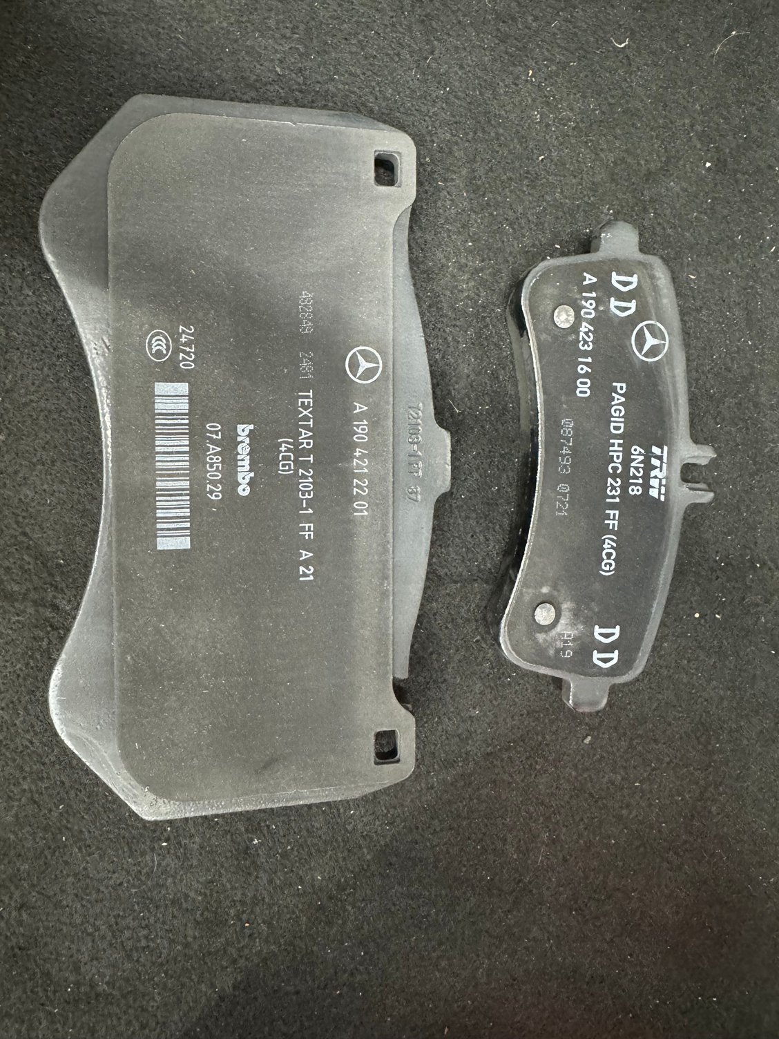

Ok, things got a little more interesting for me for my pads for the 2018 GTR with CCBs...
I ordered the stock pads from a parts supplier in AZ under $700 for the complete set shipped to me in NC.
Their part selection tool suggested that fronts were MB PN 0004203402. The Mercedes box it came in had a MB PN A0004205604 and the pads them selves have a MB PN A1904212201 (which I cannot find anywhere)
Front pad original thickness (just the pads) is 10mm. Replacement thickness should be around 4mm. My fronts are currently at 9mm
Same tool suggested that rears were MB PN 0004203502. The Mercedes box it came in had a MB PN A0004204602 and the pads themselves have an MB PN A1904231600.
Rear pad original thickness 11.5mm. Replacement thickness target 4.5mm. My rears are currently at 7mm.
So I have the parts, will hold on to them until I get closer to the thickness but hope they are the correct parts!
Sample front and rear pad received for 2018 AMG GTR with CCBs

The OEM lads are definitely marked Brembo front and Pagid rear. I must say I can not remember the rear pad being that shape, or that small(?), but I would well be wrong.
Go to the actual Pagid website and find their replacement rear CCB pad; that way you can at least verify the dimensions of the OEM pad you’ve been sent.
Old Sep 6, 2024 | 03:02 PM
dlefty's Avatar
Joined: Dec 2014
Posts: 737
Likes: 211
/////PRO
Yes, factory rear is that small…..
