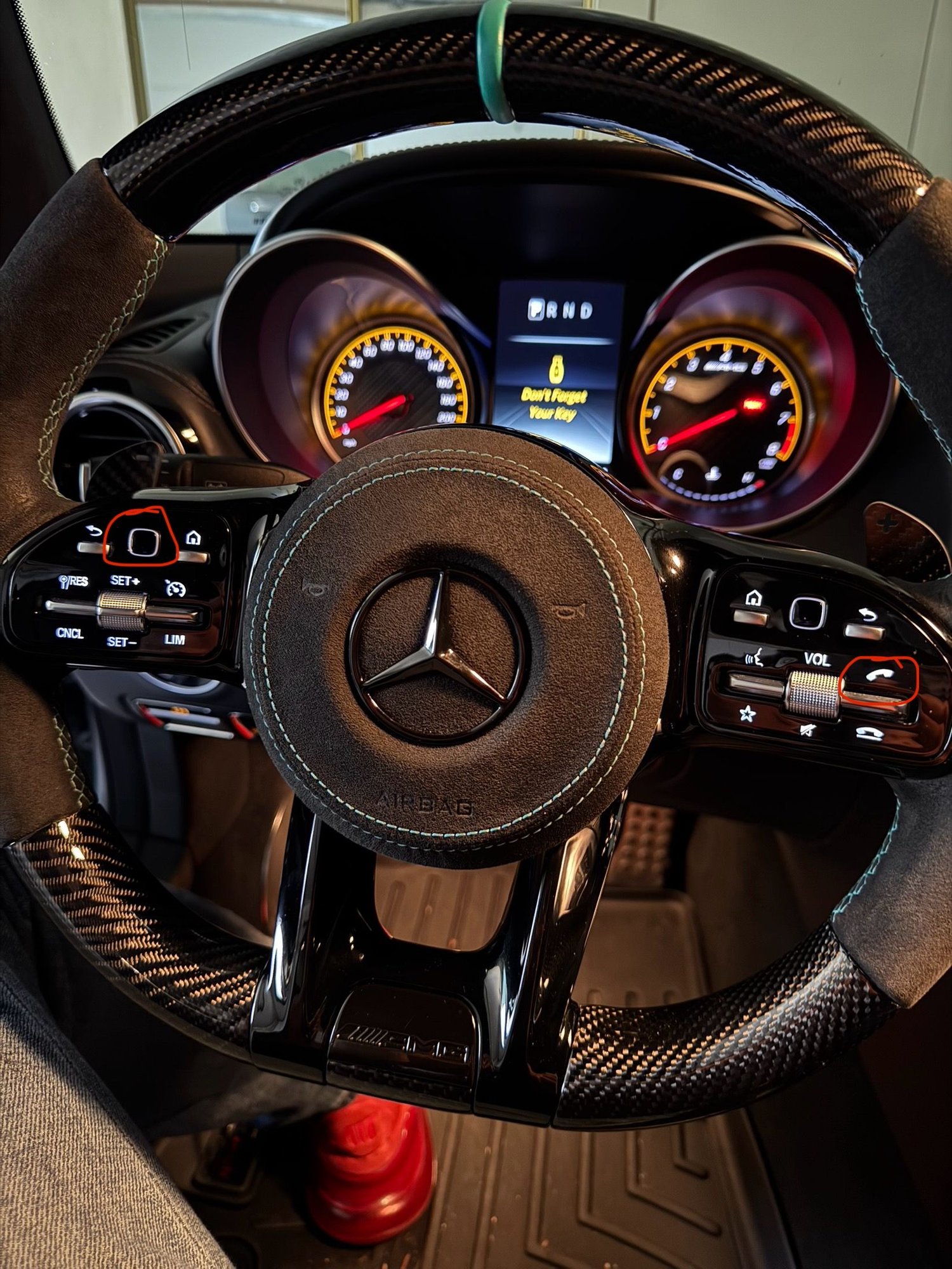

I was working on changing my rear brake pads last night and needed to put the car into brake replacement mode. I have done this on previous AMGs without any issue. I wasn’t sure how to activate the menu in this car, but after some searching I was told that I should hold down the phone button and the okay button.
I don’t have an “Ok” button, but the black haptic buttons are used for selection and “ok” functions so I held that down. On my wheel the phone switch is up or down, so I held up on the phone switch. See photo for the buttons.
Holding these buttons down did not pull up the menu. Instead, all of the buttons on the wheel started flashing off and on. They flashed for about 5-10 seconds, then stopped. Now none of the steering wheel buttons or paddles work. If I hold that combination again, the buttons flash again, but nothing else seems to have any functions.
I assume this reset something? I disconnected the battery overnight to see if that would reset whatever I did, but that didn’t work. The lights on the steering wheel buttons still work, but there is no functionality. Looking for help from an AMG mechanic or technician that knows what that button sequence did, and maybe how to reverse it. Or is there someway to reset everything to factory settings? Looking to avoid the dealer if possible because I won’t have time to bring the car in until after the new year.

I may not be able to assist with the steering wheel response, but here’s how to put the rear brake pads into service mode:
  1. Enter the vehicle and close the door.
  2. Turn the ignition to position 2 (press the start button twice without starting the engine) so that all the panel lights turn on.
  3. Set the display mode to show the Trip Odometer.
  4. Release the Parking Brake.
    • Wait for the Parking Brake light to turn off.
  5. Turn the ignition off.
  6. Turn the ignition to position 1 (press the start button once).
  7. Press and hold the black button on the left side of the steering wheel for 2–3 seconds until the display changes. (Refer to the picture for Button 1.)
  8. Press the "Return" button (labeled as Button 2 in the picture).
  9. Access the workshop menu.
    • The workshop menu should now appear on the display

hey man, thanks, I figured it out. I think the flashing was some kind of reset sequence. I held the two home buttons and that set everything back to normal.
To access the service menu it’s actually the phone button and the okay button on the right side of the wheel.
